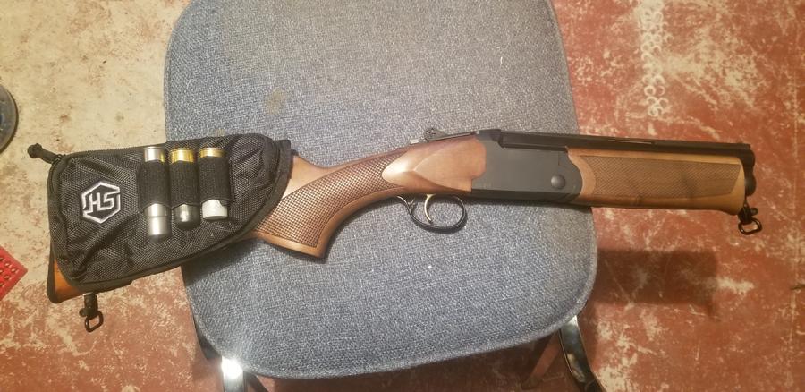

Stripped the grit, lubed and it falls open past the first chamber.
Made a short stalk extension and it handles the larger rounds nicely.
Thanks TI

I Cut an old shotgun stock down and removed the small but pad. Did a simple attachment so I can remove it if I ever want to.
I had done a leather slip on for a 44 mares leg and found the recoil would loosen the leather to much. Figured a 12 definitely wouldn't hold up.
Decided to cover with the shell holder rather than refinish and match. This has a nice soft cheek piece as well.

Ah ok nice I wish I had an extra stock lying around to chop haha.

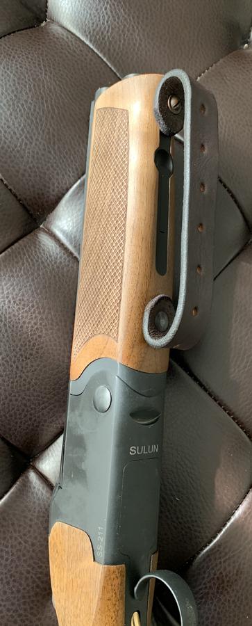

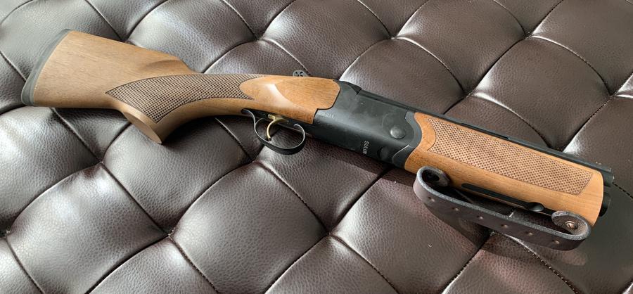

I embraced my inner bubba and used a piece of leather belt to make a hand strap.
Rules had already been broken, so why not.
I used the existing rear Chicago screw, but added locktite and cranked it hard to compress the leather and get a good bite. I had to carefully drill for the front screw, but am fairly confident it is strong and won’t crack. Fingers crossed.
