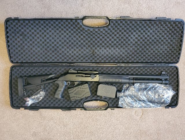

For people out there looking to swap the factory adjustable stock on their SULUN Arms TAC-12 this info may help. I have compiled the sources I used and other info that may be of use to owners.
Please feel free to add any experience. Q+A, quality control etc... The more info the merrier.

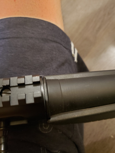

4. Some have the pistol grip not all the way turned in and tightened#
