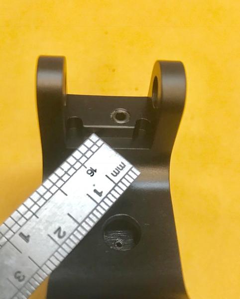

If you purchased your Super Sabra in the last 2 years or so you should have a Gen 2 Super Sabra, which fits both Tavor SAR and X95. The difference between Gen 1 and Gen 2 is the addition of a "u shaped" groove on the lower housing to fit the X95 receiver. You can see this in the picture, at the ruler tip.
yes its recent, and the I should be able to put the x95 pack in my original first gen Israeli tavor?
