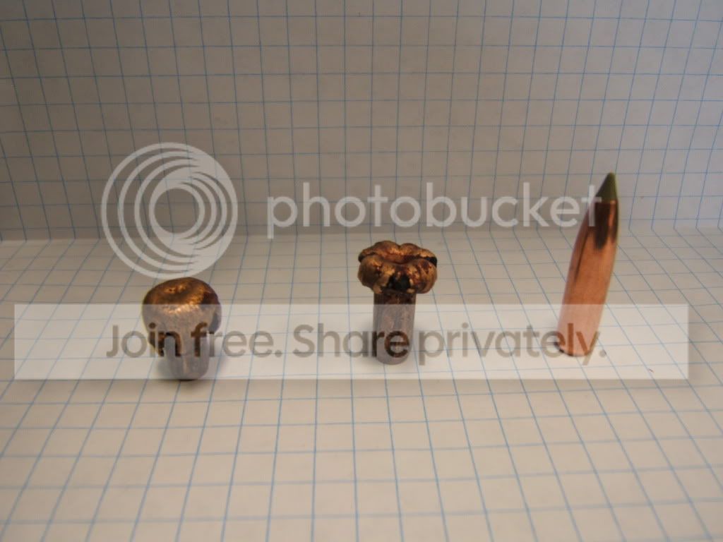

Long story, but I ended up shooting a doe lengthwise with this 139 GMX suprformance load. I didn't chrony it, but the impact velocity would have been in the 3000+fps range.
After travelling in a straight line through about 3 feet of deer, it almost, but didn't quite make it through the skin on the front shoulder of the animal. It doesn't appear to have hit any bone, although I haven't started processing the animal at all, other than field dressing and skinning it. It seems to be pretty much identical to the performance I'd expect from a TSX under these conditions - it opens quickly, but not as quickly as a ballistic tip or SST. Meat damage is nowhere near what the OP has, but that's probably all down to difference in shot placement.
Anyway, I'm pleased overall with this bullet. I'd have no reservations about trying a quartering shot on a moose or elk based on what I've seen so far.

Update
I cut up the deer today and upon closer inspection it seems I was incorrect yesterday. The bullet did not exit in the rear as I thought yesterday. It exited just infront of the rear leg, turned sideways it seems (petals pushed back up) and I found this bullet inside the top round muscle sideways. It weighs 134.4gr.
hmm - compared to the photos on Hornady's site, that looks pretty similar to the '2700 fps impact' picture. It's quite a bit less expanded than mine, which was at a much closer range (95 yards lasered).
Interesting - this bullet seems most at home in Magnum applications; I definitely would not trust this bullet in lower velocity cartridges

Impact speed was ~2600fps at 250 yards. I agree the monos are best when pushed fast. If I am lucky I may go moose huntig this year yet. I will be using these.
That doesn't look bad compared to shooting Berger's.... you have potential for lots of meat loss with those, from the 5 deer I have shot with those the only direction a deer does is straight down. I had a GMX load for elk this year but have not been able to use it yet. We have shot ballistic gelatin with a 300 Weatherby and 165 GMX's at at 100 yds our 28" block could not stop it.
I've seen some magzine reviews, and it seems like you need a little more than 35" of gelatin to stop the GMX. Pretty consistent with my experience - it took about 3' of soft deer parts (no bones struck) to stop mine
