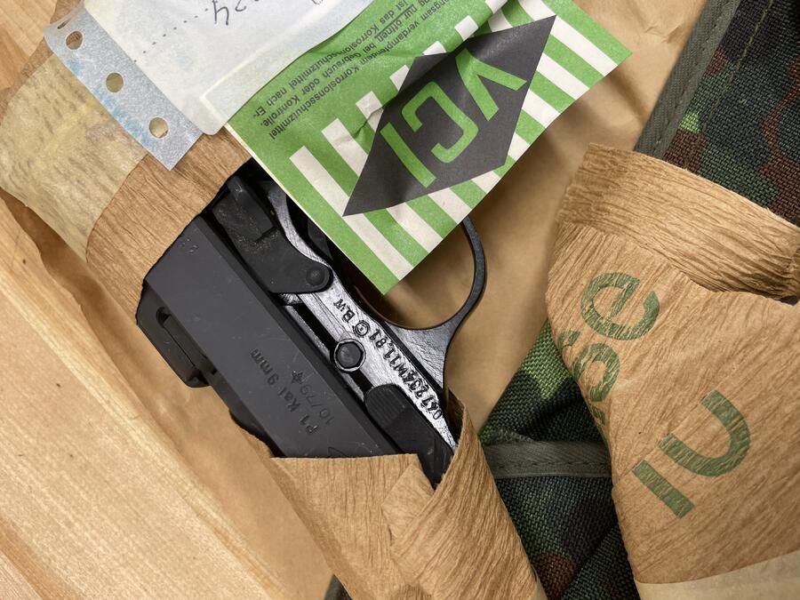

Surplus Walther P1's
They rolled in.
We need to take photos and get them uploaded to the website, but they all appear mint un issued and dates vary from the 1970's to the 1980's.

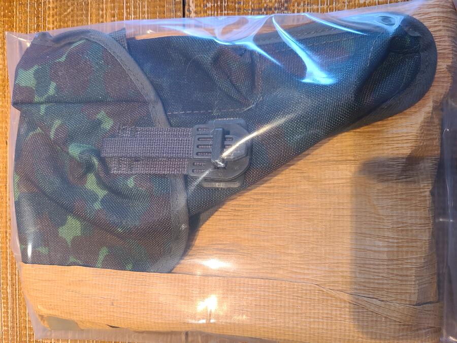

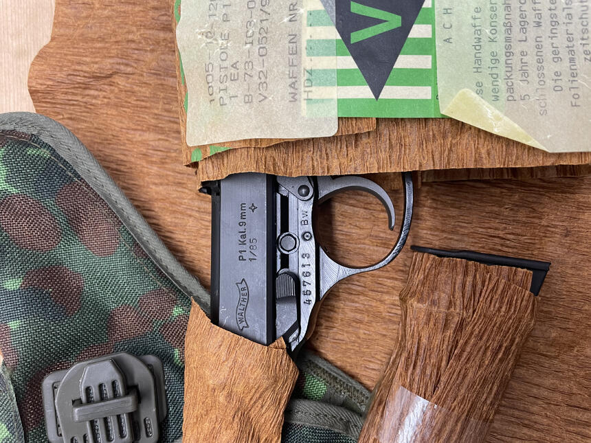

This batch all have the Military Flecktarn holster.

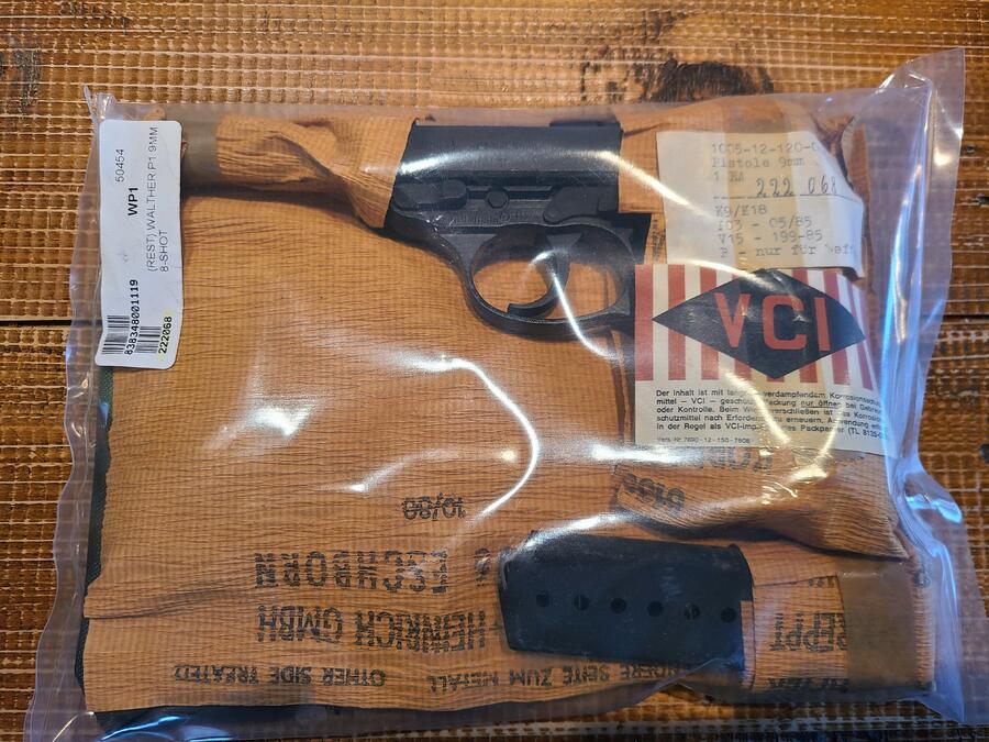

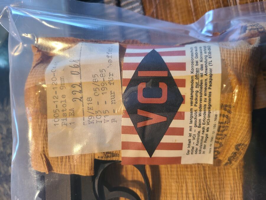

They all come with 1 magazine

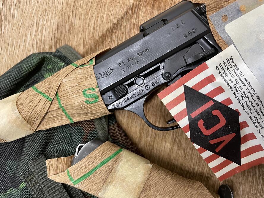

Stone cold MINT surplus. At least as mint as a bagged P1 Surplus pistol from 1984 can be.

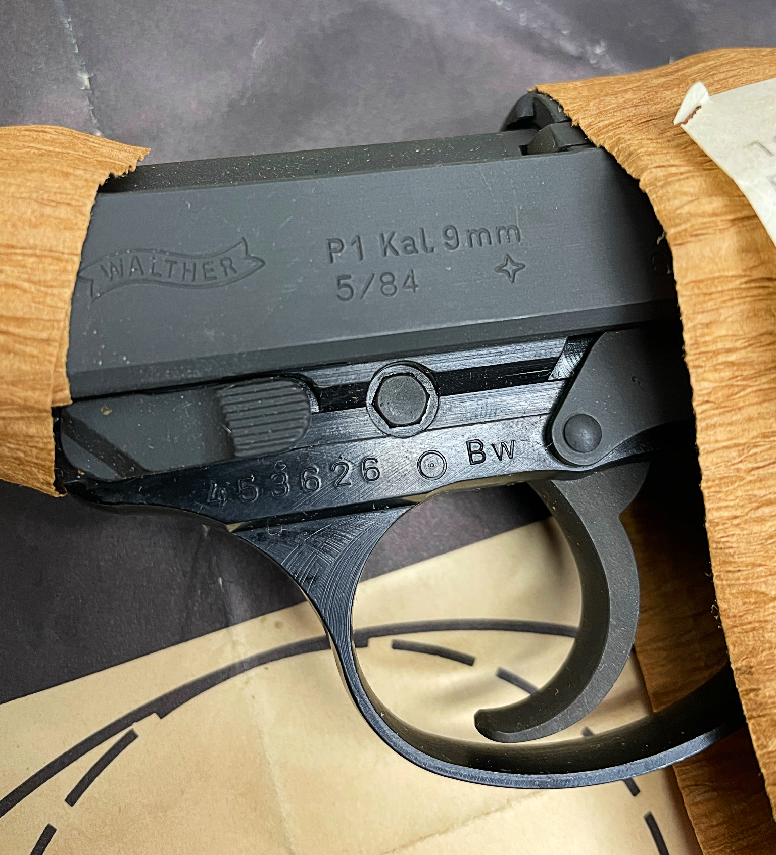

I pulled one for photos.
05/1984 dated. A full 5 years before the Berlin wall fell!
This one comes with the original test target (some come with this, some do not).
YES. P1's without them will crack the frame eventually. That is why a STEEL hexagonal pin is inserted as a reinforcement to to the aluminum frame.
This is incorrect. a quote below from 05RAV to hopefully clear this up.
WRONG!
https://www.thehighroad.org/index.php?threads/aluminum-frame-walther-p-38-p-1.159973/
(Quote)"Note the comment in one of the above posts that the hex-bolt was not installed to prevent the frame from cracking but to reduce wear (read rounding or peening) at a key point. When you disassemble the P-1, you'll see that the hex bolt comes into play with the locking bolt when the slide is returned to battery by the recoil springs and not when the locking bolt strikes the frame from the more violent blow-back forces of the fired round.(end quote)
(Quote)"The fact is, the steel reinforcement pin was NOT to prevent frame cracks, it was to give the locking block a steel "wear surface". Walther's that were heavily shot tended to wear the soft aluminum ramp in the frame that operates the locking block. When the ramp wore enough, the gun would start to have locking problems.The steel pin was installed to give the steel locking block a longer wearing steel surface. THAT'S why the pin is hexagonal in shape.
There are a number of reasons aluminum P-38/P1 pistols will crack frames or slides. Some of the most common:
1. Shooting hot ammo or heavy bullet loads.
These guns were designed for use with standard load 125 grain bullet ammo.
Shooting hot ammo or bullets over 125 grains can cause cracks.
2. Using "extra-power" recoil springs.
While extra-strong recoil springs may "pad" the frame from hot ammo, people fail to understand that the slide ALSO slams SHUT with greater force.
It's that extra-hard slide closing that literally hammers the frame forward and cracks it.
A look at the posted broken frame shows that the frame was hammered FORWARD not rearward".(end quote).
By the way, I've been shooting the Walther P1 for over 5 years so I know well how it works.
So... in your new P1 be sure to fire only standard velocity target ammo in 115 grain to 124 grain bullet weights. Avoid any +P or NATO marked ammo. These pistols are a piece of history, treat them as such.
