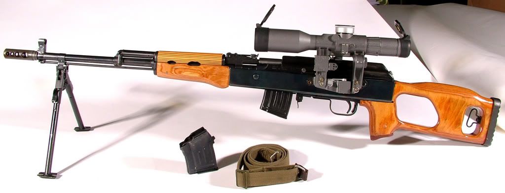

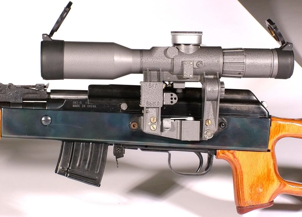

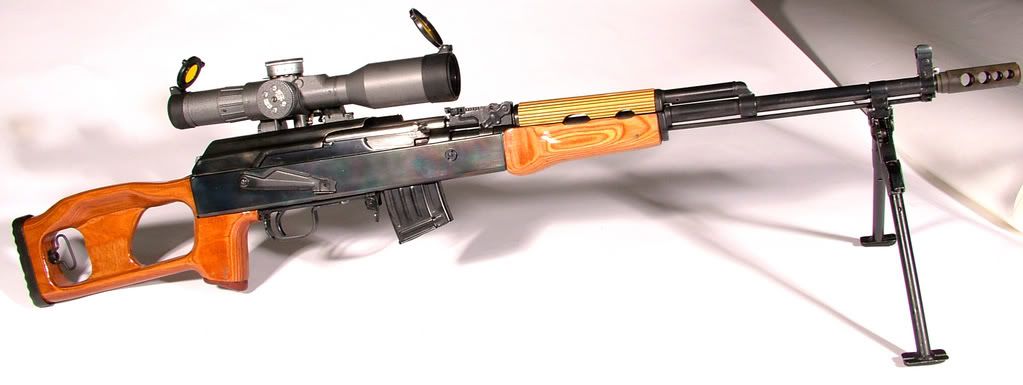

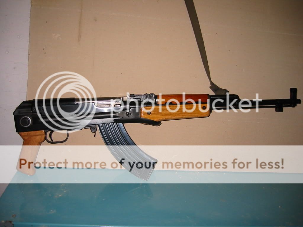

Found some pics may be its useful along with your imagination you can create something out of it.
These are not my pics but someone posted before I think these belong to two different members here:
That last one looks like the love child of an mp-40 and an ak :p

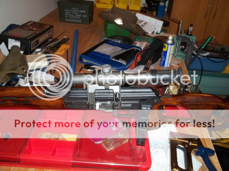

So as of tonight this is where it sits... never fast enough but it is coming along. There's tons of stuff I've missed documenting but suffice it to say it all takes time... the devils in the details.
What really takes the time is just ruminating and trying to come up with a way of doing way I want to do with the limited resources and tools I have. Its not like I have a machine shop to use and both of the gunsmiths I knew around here closed up shop. Given some time I think I'll try to take a stab at the reciever shroud next weekend... if work cooperates.:D
