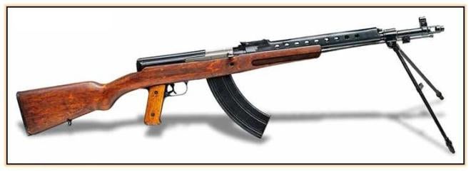

Fedor Tokarev's AT-44 was ready for field testing in early May 1944. The AT-44 utilized a gas regulator mounted to an integrated unit providing the gas block, front sight, muzzle brake, and bayonet lug. Versus the SVT-40, it had a shorter receiver, smaller bolt face, relocated trigger (to accommodate a pistol grip), and a selector lever located on the lower rear portion of the trigger guard. The automatic fire mechanism of the AT-44 was very simple, with the position of the trigger itself determining semi- or fully-automatic fire.
Huh, that's really interesting - I had never heard of the AT-44. It looks a lot like the one in the video below, though obviously they have very little in common internally...
https://www.youtube.com/watch?v=XE3m1C4gWHU
