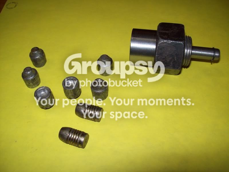

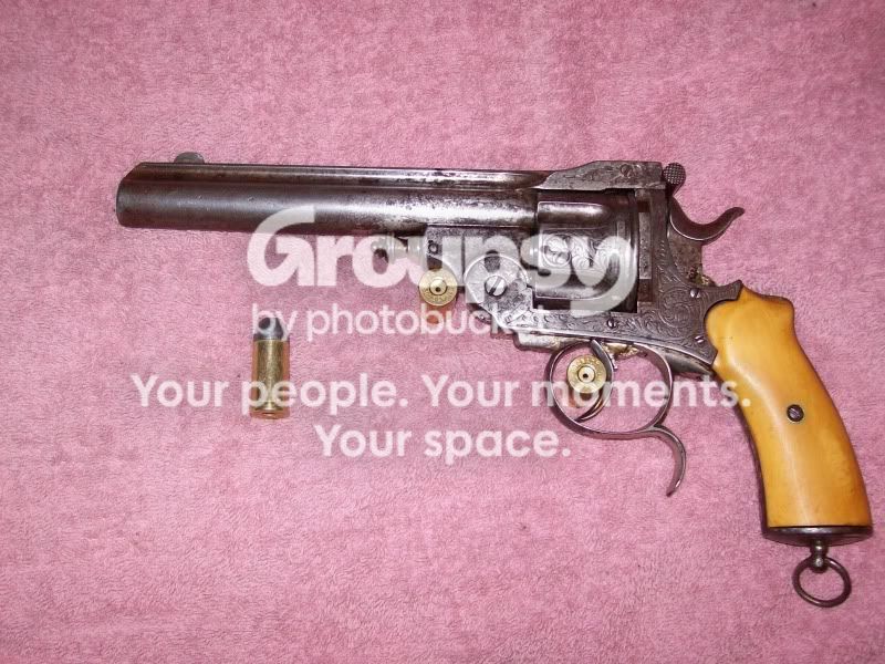

here are some pics of my swaged bullets for my 50 cal antique.
i started useing 44 cal tumbble lubed bullets. i then tried reg lubed
bullets lubed with the NRA alox/beeswax lube as per the cast bullet group.

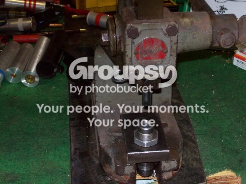

it works great. these are a heeled bullet. nose is .510 and the heel is .483.
i use a small atlas arbhor press for swageing.

there is no brand. that is the die that i made in the pic. i use an old atlas arbhor press.
these are some bullets useing lee 44 cal tumble lube bullets. notice they are hollow base.
Thats a great press and Die set up.
I see some big Alum flare cases in the back ground to.
Great job on makeing the die.
