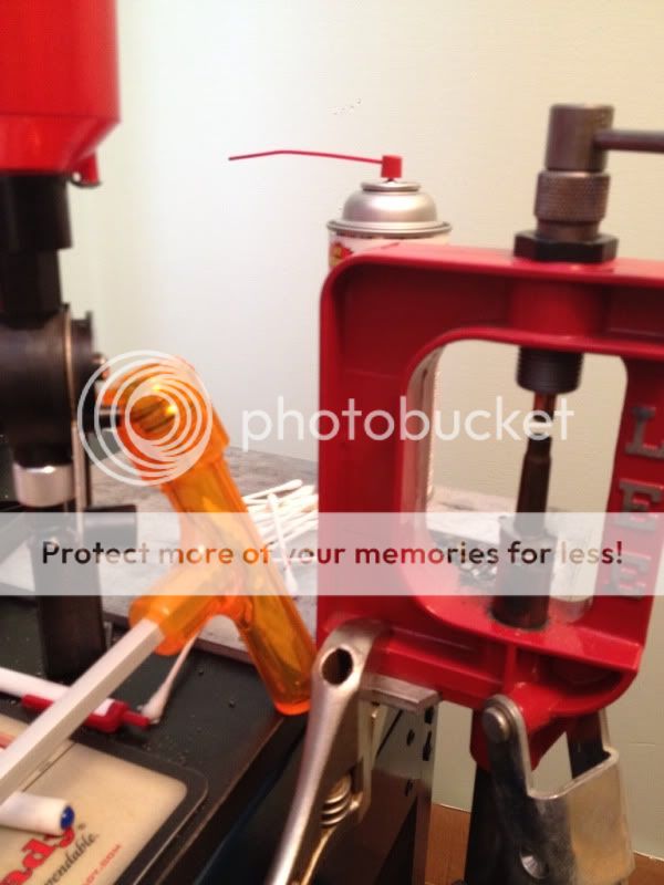

A lot of mine don't survive the removal process very well with my collet puller...
Really? I pulled almost a full case of Czeck surplus with my Forster collet puller, and you have to look pretty hard to see marks in most of the bullets. The few that slipped out of the puller have pretty good scratches; but I found the trick is to make sure the bullets and the inside of the collet are well degreased.
I tried the "seat the bullet a bit deeper" trick too, and I found it wasn't worth the extra effort.
We have a magnet at our range for picking up the spent cases but most of the users assume it is not for their use. The big sweep will pick up a bucket of cases ahead of the firing line in no time.
Banning is still an option.
Got one, too slow... And really hard On it to pull x39.
I'm sure I can still shoot these but I just don't see the point...
