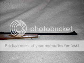

All right, I got the seller to send me a couple of pics before I pick it up. They are small and grainy, but maybe someone can pick up enough to help me out.
Any thoughts?

Lots of different Mauser bolts. Some shorter, some lugs different,some bolts bent, some bolt faces different even before being opened up. I think some people already said confirm which 98 rifle you have. Confirm cal. and look for proper bolt for that rifle or another simular manufactured bolt that will fit/function. Then you can headspace check. If headspace no go, time to take off sights, the barrel and do some lathe work.
Yes Mauser bolt interchangeing usually more work than Lee Enfield.
Generally speaking, to put a scope on a rifle like this one, you would need: a bolt with a handle altered for "low scope"; appropriate holes drilled and tapped in the receiver; a replacement safety to clear the scope.
IF you could find a commercial sporting Mauser (PH, Santa Barbara, Mk. X, etc), that would solve the bolt handle, IF headspace was OK, and IF both lugs made contact. Fitting, including brrel set back could be necessary. Or, the existing handle could be cut and welded, forged, or replaced with a streamlined one. The latter makes the best looking alteration. Keep in mind that the receiver will likely have to be altered to clear the low handle. Altering the existing bolt won't change headspace.
Once you have the rifle in hand, you will be able to consider your options. Whatever way you decide to go is going to cost.
