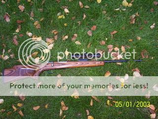

Here is a before pic with the original stock.
If it still has the rear sight base - dont be scared to look at a B Square no drill and tap mount and a scout style scope - put this together for my daughter and we have killed three deer with it so far.
Stock was from Boyds - minor fitting required.

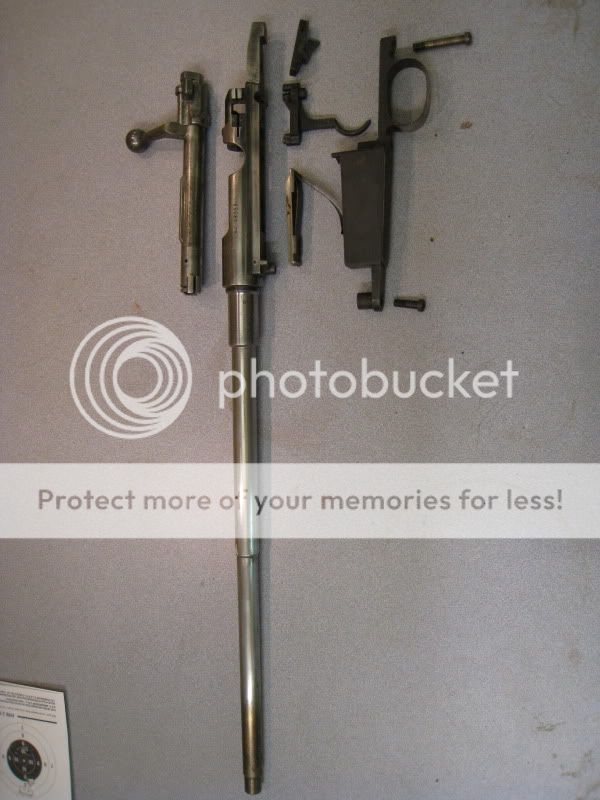

Some Pics:

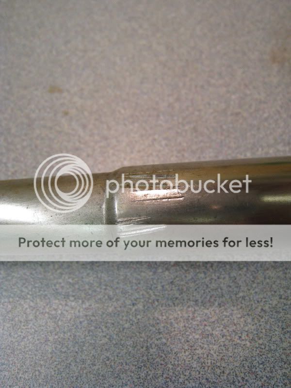

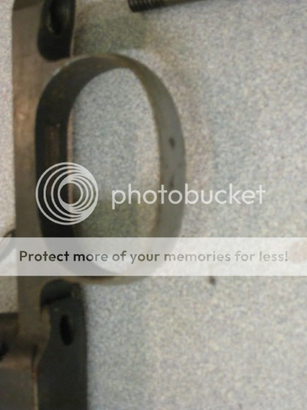

Here are a few pictures of what I'm dealing with.
Somebody trimmed down the trigger guard.
The pipe wrench marks aren't as bad as I remember....

The barrel is only a bit over 18" long. I don't think that is long enough to do what I want to do with it.
It looks like I'll have to decide between getting another barrel and selling it.
