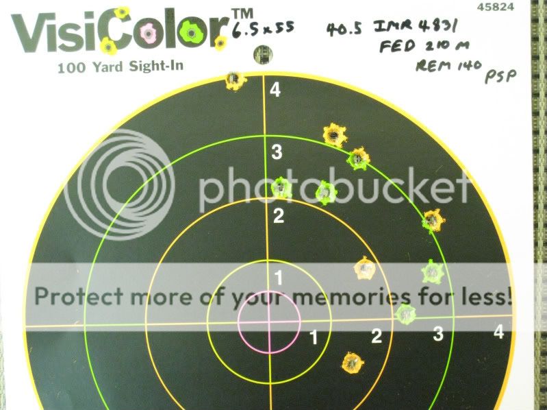

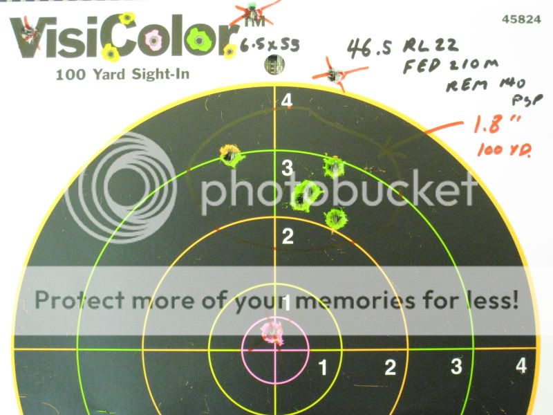

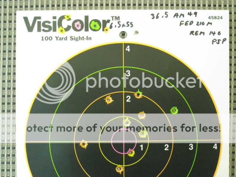

I finally got a chance to shoot some targets with it.
It turned out I couldn't get the receiver sight low enough to aim directly at the bull. I had the targets taped to clay pigeon boxes and I ended up having to aim at the bottom edge of the box, which seemed to work ok.
I've since relieved the stock to allow the receiver sight to slide down further.
All targets were shot from prone at 100 yards.
I had the best luck with RL 22. Got a 5 shot group of 1.8" (4 into .8"). The other holes on the target were from getting the sights adjusted:
I fired 2 ten shot groups with two other loads as well:
I guess it shows potential, especially with the RL 22 load. I'll play around with it some more but it looks like I'll probably keep it in it's current form and just blue it and refinish the stock. Then I'll decide whether to keep it or sell it.

46.5 grains of RL 22 is a waste of powder in that short barrel.
Personally I wouldn't go above 45 grains or RL 22.
Shame someone chopped up that sweet carbine, but good for you for keeping it functional.
Wow....imagine wasting a whole 1.5 grains of powder:eek:
Personally my Sweed shot so well with 46.5 gr. of RL-22 that I wasnt' about to start downloading so I can save on powder .
