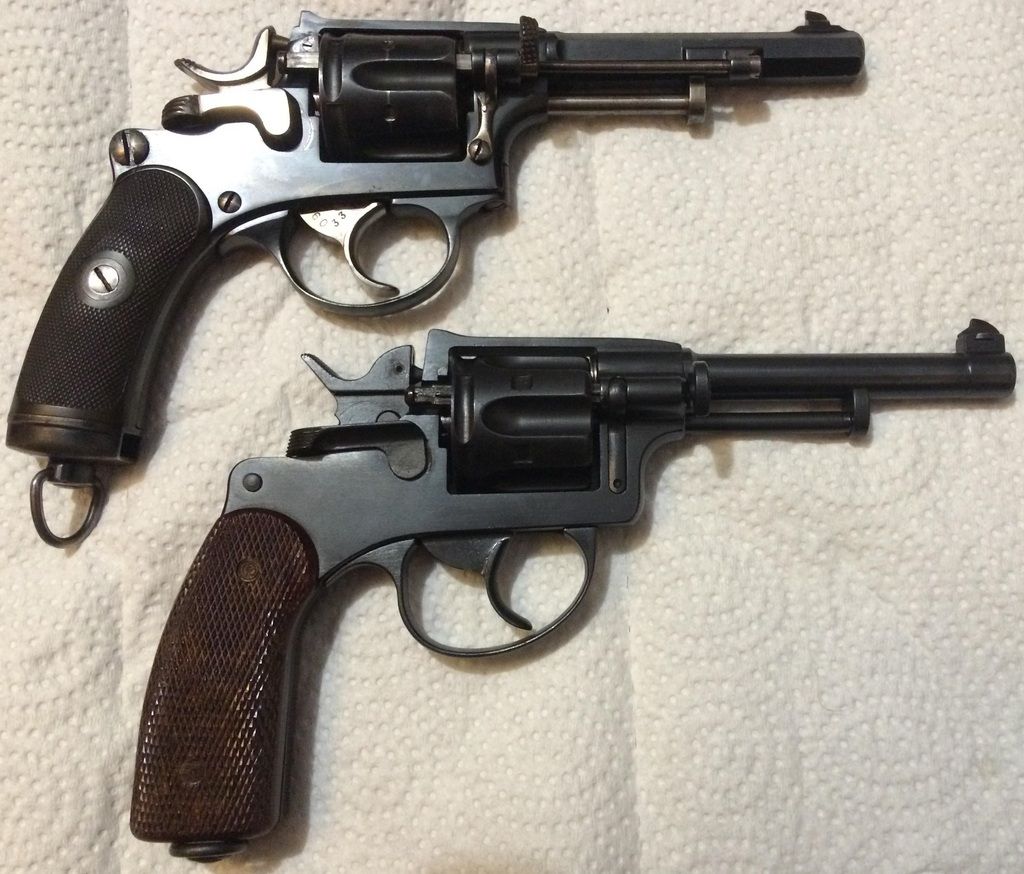

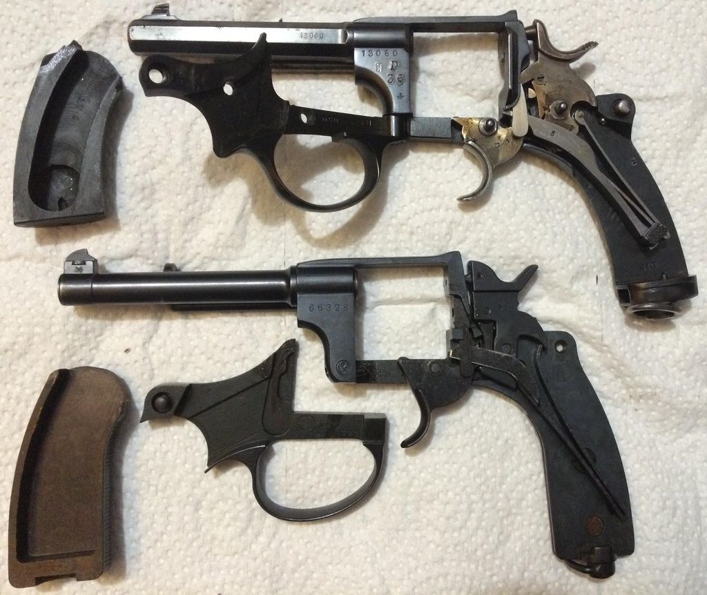

So I thought I would do a bit of a comparison between the Swiss 1882 and 1929 revolvers. When the 1882 revolver was first developed it was one of the most modern revolvers in the world, even remaining more relevant than later designs *cough* 1895 Nagant *cough*. In 1900 the Swiss adopted the Luger, however they decided to still keep using the 1882 revolvers simply due to the fact it cost 1/3 the cost of a Luger. They just issued the 1882 to officers who wouldn't be likely in combat but still needed to have some sort of weapon (i.e. supply, etc.). In the late 20s the Swiss were looking to simplify there service arms to make them as inexpensive as possible (as Swiss service arms in general are always expensive). The results were the 1929 Luger, 1929 Revolver, and the K31.
Overall I would say the 1929 is definitely a cheaper arm. It has some improvements (stronger frame, cheaper, easier to manufacture), but the quality isn't nearly as high as the 1882. Holding it, the 1929 is also much more 'squarish' than the 1882 and doesn't fit as nicely in your hand. That doesn't mean it is ineffective, simply that it isn't as nice. Well in any case here is some photos detailing some of the differences between the two.
1882 on top, 1929 on bottom

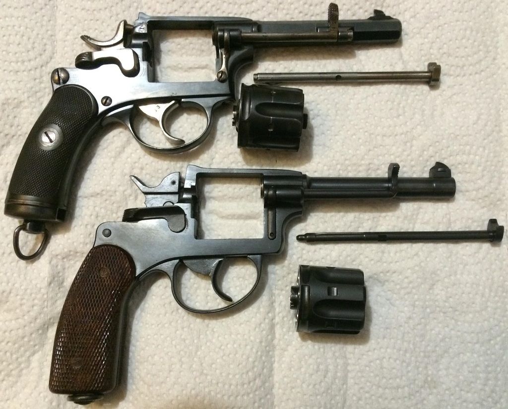

field stripping is the same between both

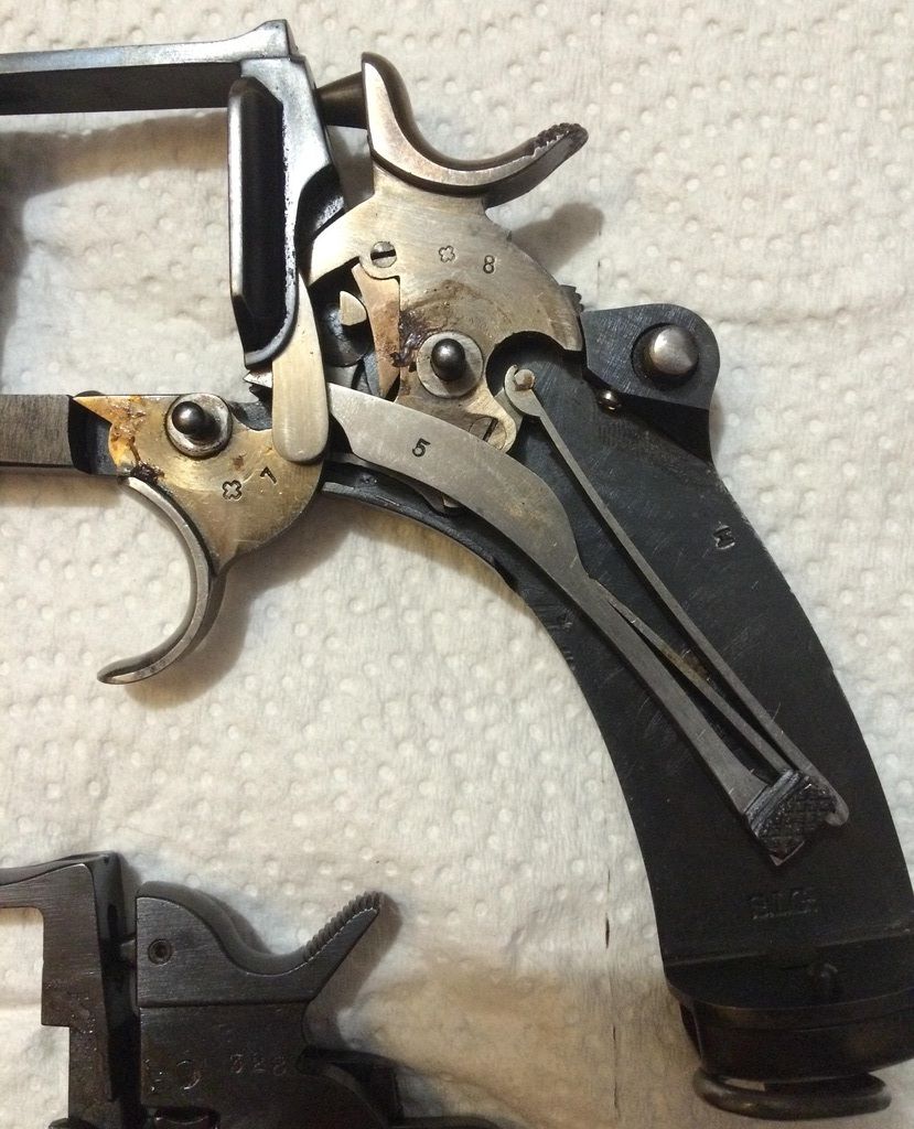

1882s lockwork in the revolver

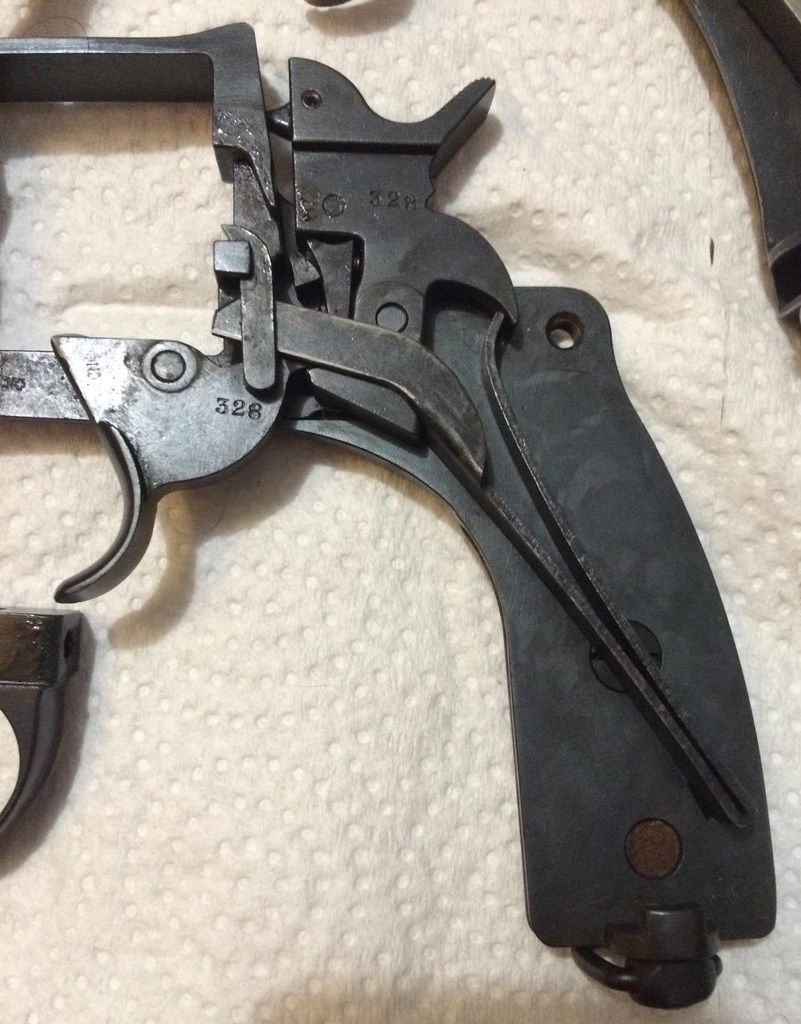

1929s lockwork in the revolver

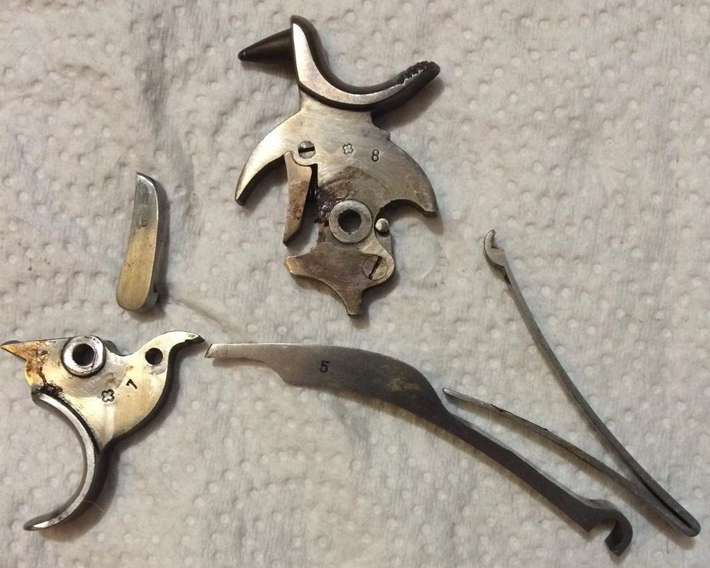

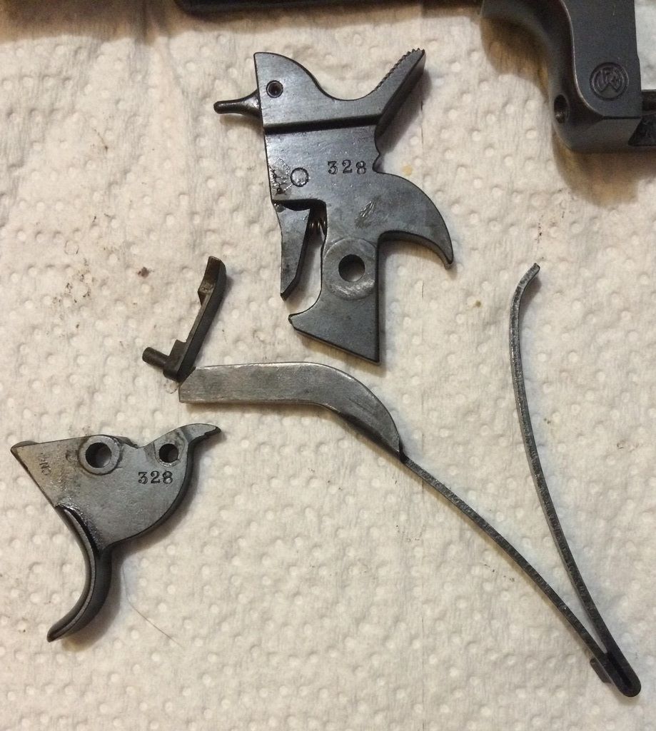

1882 revolvers lockwork disassembled (note the numbering on the parts to tell you the order to disassemble)
1929s lockwork disassembled (note the lack of numbering)

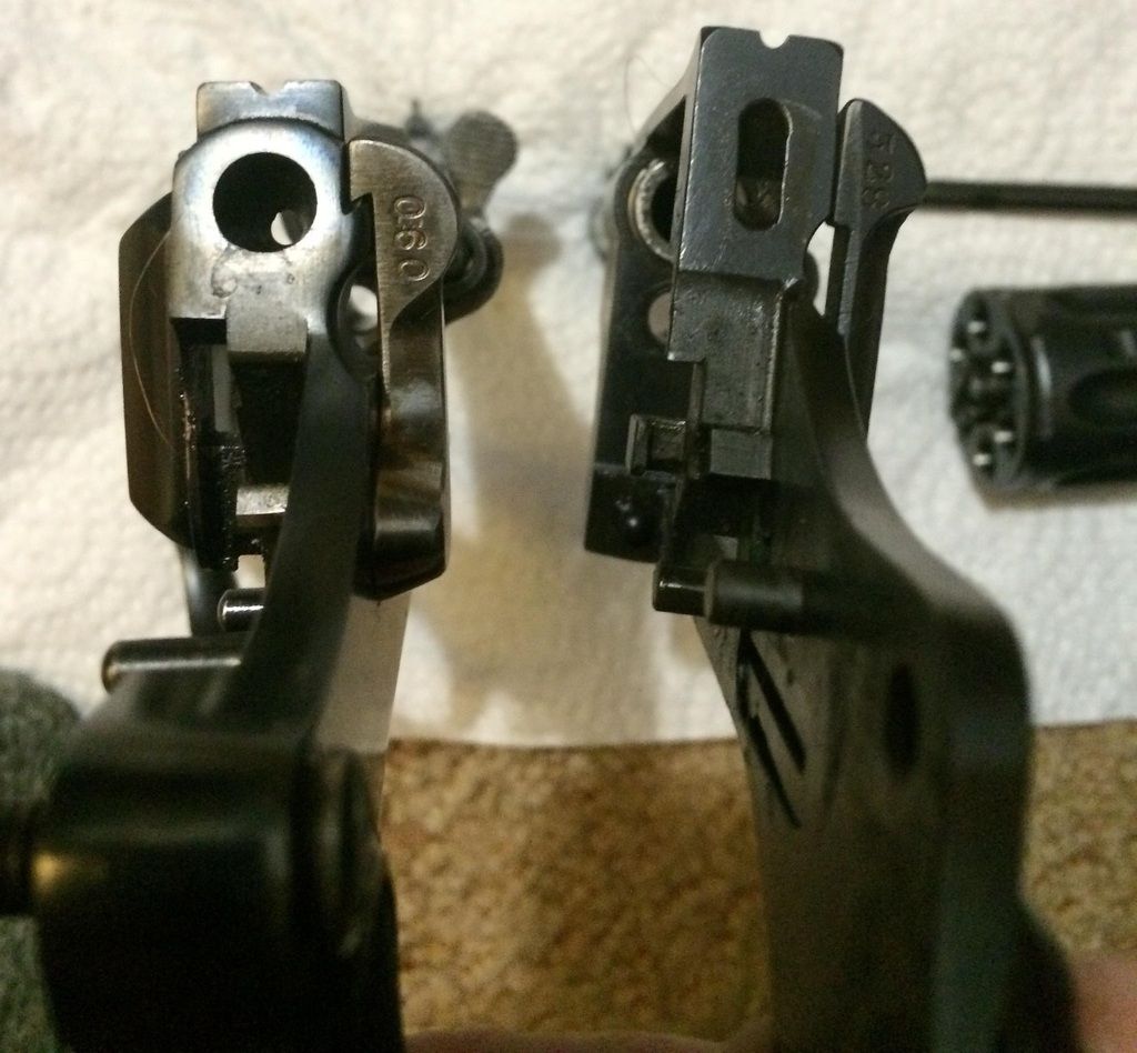

Showing the difference in cuts in the revolver frames, 1882 on left, 1929 on right

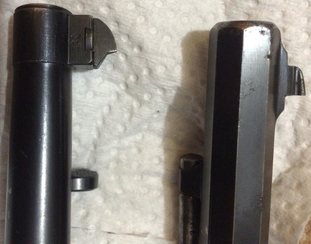

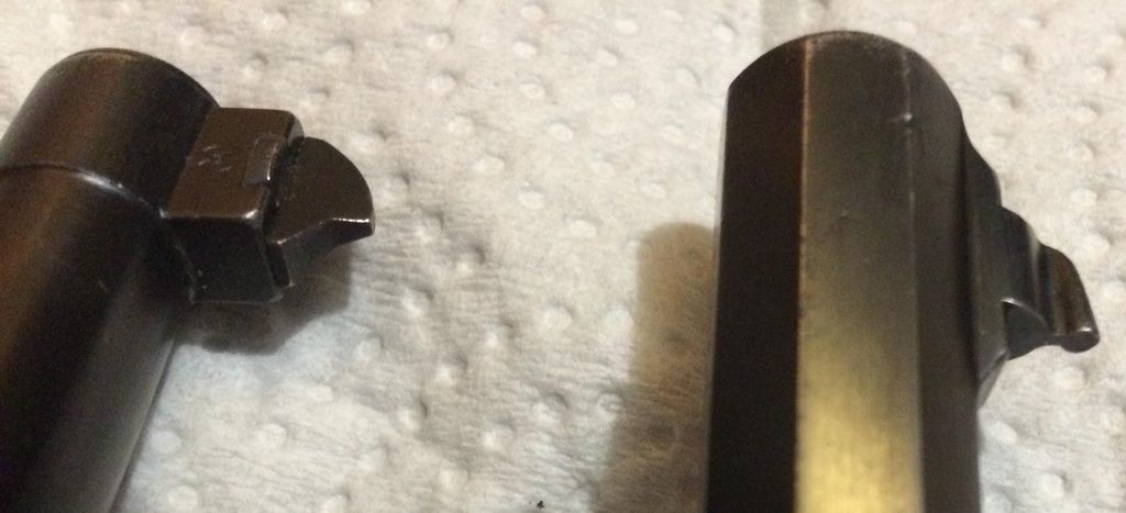

showing the difference in front sights, on the 1929 it is a simple blade which is windage adjustable, well the 1882 has a ball which is non-adjustable (I prefer the 1882 sights)

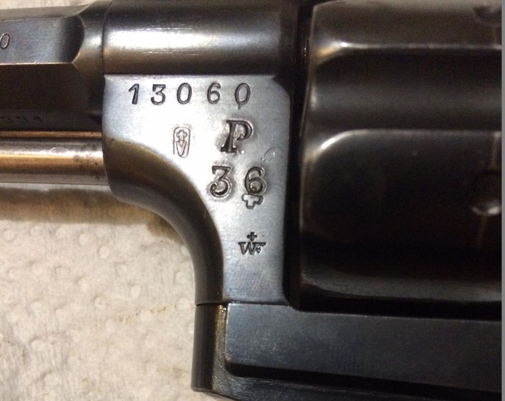

Markings on the 1882, note the 'P36' stamp which signifies being sold out of service

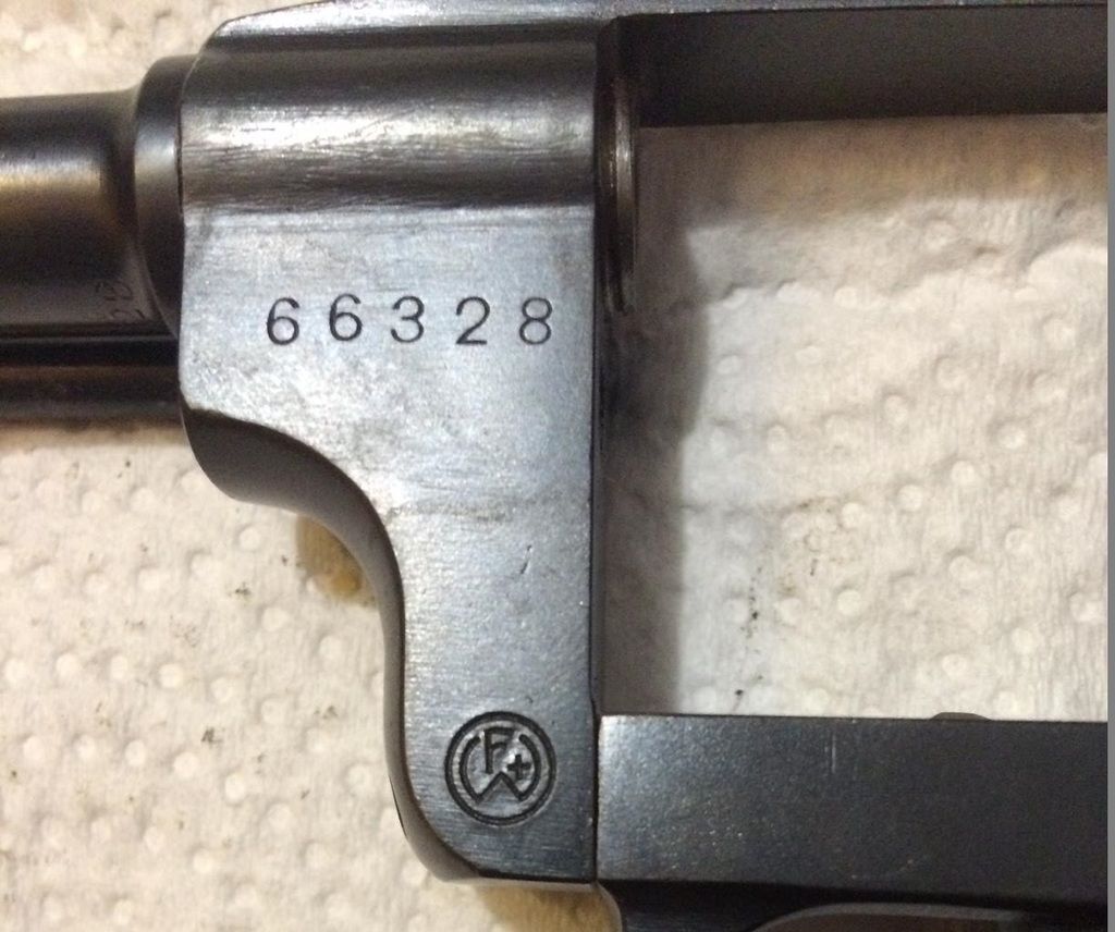

Markings on the 1929, I suspect this example was never issued as there is no wear anywhere.

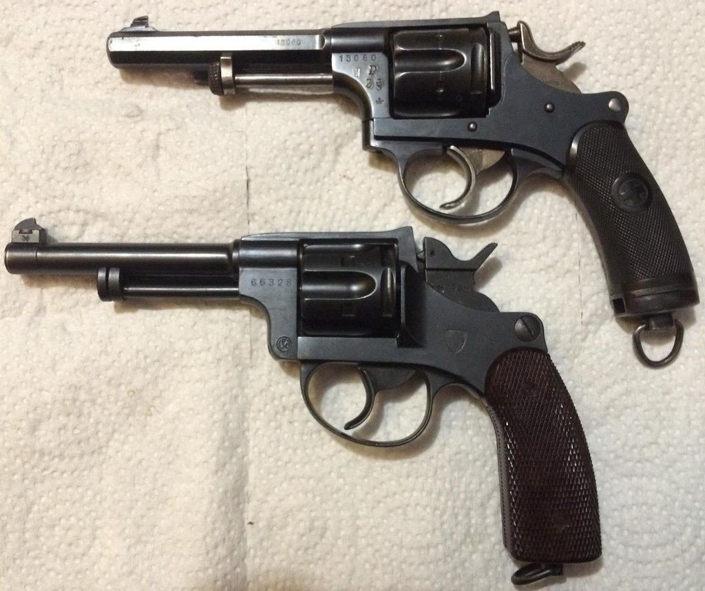

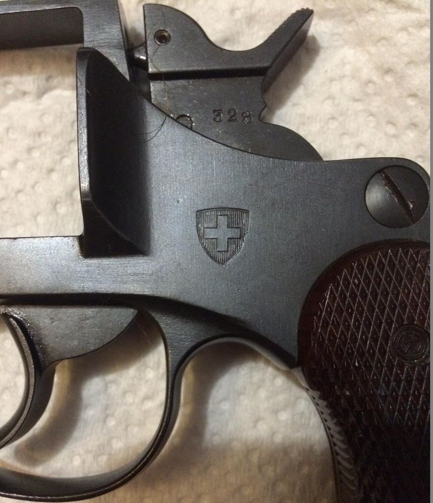

Nice swiss cross emblem on the 1929, the only real nicety added to the revolver system.
