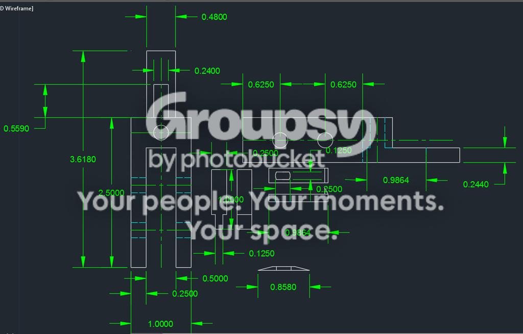

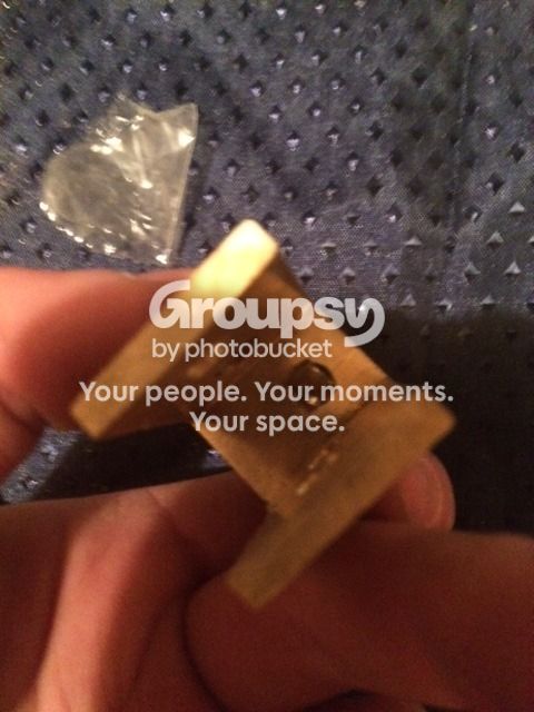

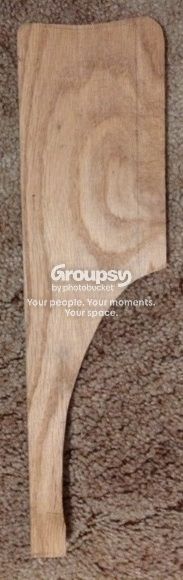

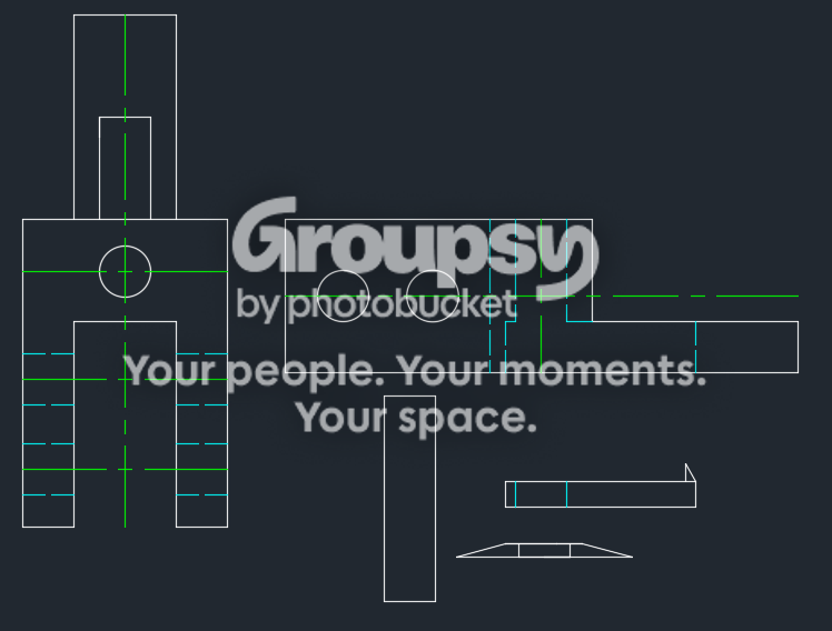

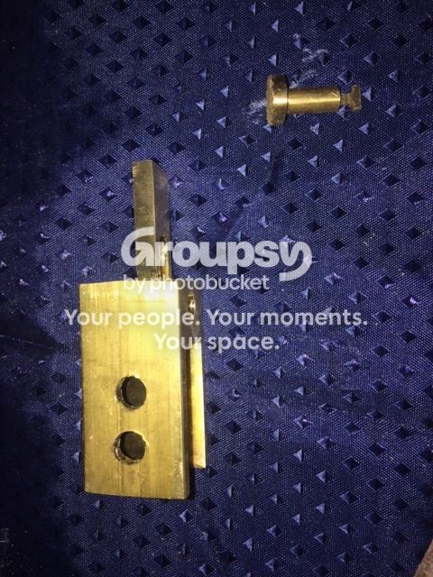

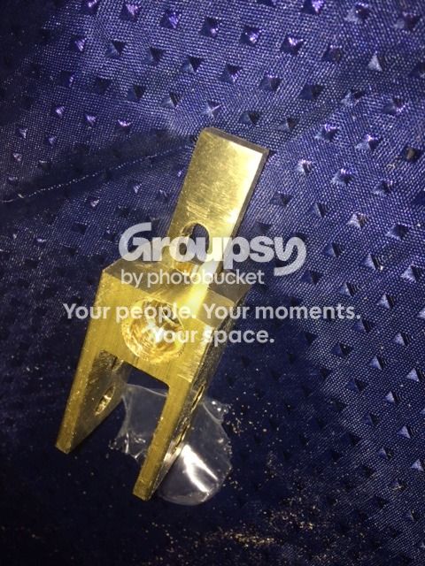

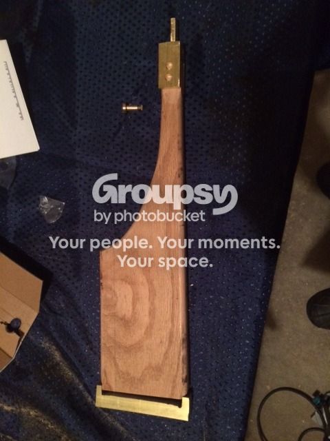

What this means for the design is now the cut out portion of the stock needs to face downwards as otherwise you can't use the sights on the revolver (the problem when you design things without having the actual item, now I know how mechanics feel when they get the engineers design). Now that I have the main part fitted to the revolver, I need to make the catch mechanism, and based on what I have done so far, there is a lot of needle filing in my future.
