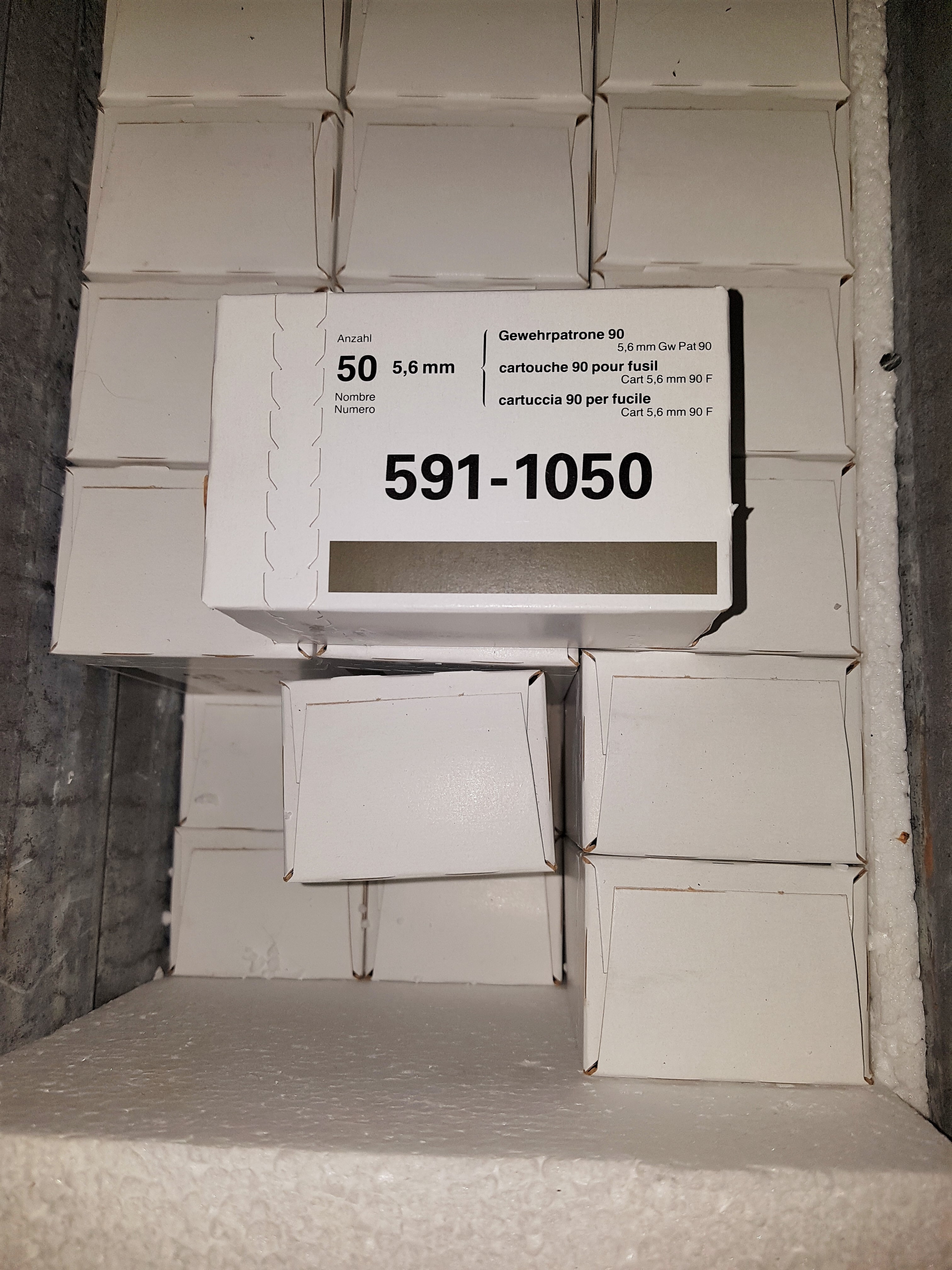

Also know as GP90 - 63gr is right, loaded to pretty much 5.56 NATO specs.
(Geco sells it in 50rd boxes with the rounds in strips of 10 commercially)
Should be fine with the crimp removed as above (Used to shoot it a lot. Was ~20CDN for 50 when I live in Geneva, generally good ammo)
