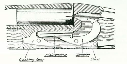

Sounds like sear to tumbler engagement problem. Years ago I had a 10ga double that did the same thing. Tip of sear was broken off.
I've also seen several percussion shotguns that had a similiar problem due to the stock restricting the movement of the sear. A quick buzz from a dremmel fixed the latter.
I found this image, I'll try to learn from this and share the info.
