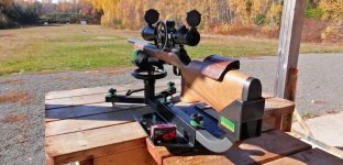

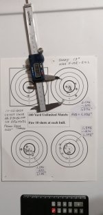

Is your rifle 'sub-MOA' at 50 ? Do you have the trigger adjusted as low as possible ? Do you use a Very Stable Front/Rear rest system (as Jahn posted while I was still typing) ? I've never even fired a T1X, but my VMTR often shoots 0.3-4xx at 50 and 'sub- 1-1/5" at 100. I have a Timney at ca 3-5-oz and an 8-34x56 FFP scope, shooting from a one-piece sled.
Range CZ457 VMTR 100yd 10-22-2024 COPY.jpg Range 2024-10-22 pic for CGN 100yd Challenge #1.jpg
