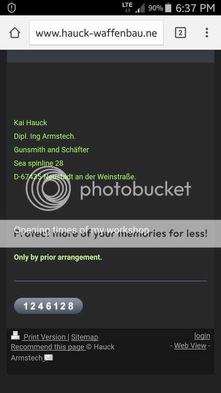

From Hauck's Guestbook:
Anthony Tornyi
( Thursday, July 21, 2016 14:11 )
Dear Sir, We are a Canadian firearms importer and distributor. I have Several hundred Italian M1 Garand receivers and would be interested to export them to have them built into complete rifles. I
would be interested to hear from you Regarding this Possibility, price etc. Looking fo4rward to your reply, Anthony Tornyi
That is Anthony from TradeEx. Maybe he will choose to look at the possibility of finding other potential shops able to build complete Garands... TradeEx does have lots of receiver, I think I should get one or two simply for future use!
