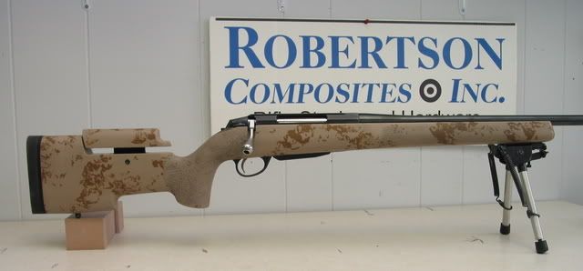

Ask and you shall receive. Well worth the wait and every penny.
which model stock is this?
Ian, I had to look in to my emails, but this thread popped up the same day I emailed you about a stock for my Tikka, coincidence?
I am trying to justify that stock with the cheek riser, it would make a beautiful bench gun but the way I have to contort myself some days in the field I don't know if it would benefit me. Then comes the color decision.. So many options, so little guns.

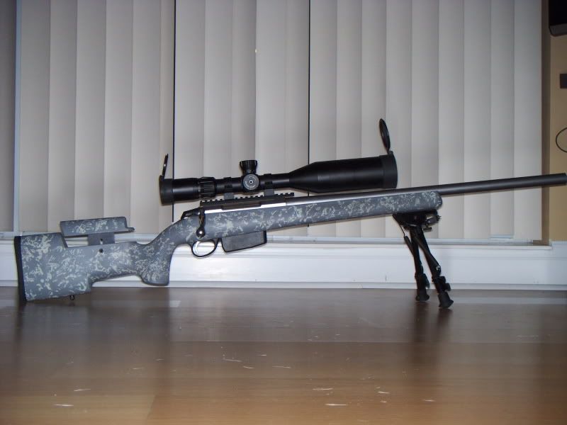

I really like that stainless barrel in the stock, thanks to whoever posted that picture.
Frankie, very nice. Compair it to the rifle I bought from you.
More comfortable due to the adjustable cheekpiece. I also like the paintjob quite a bit better.
