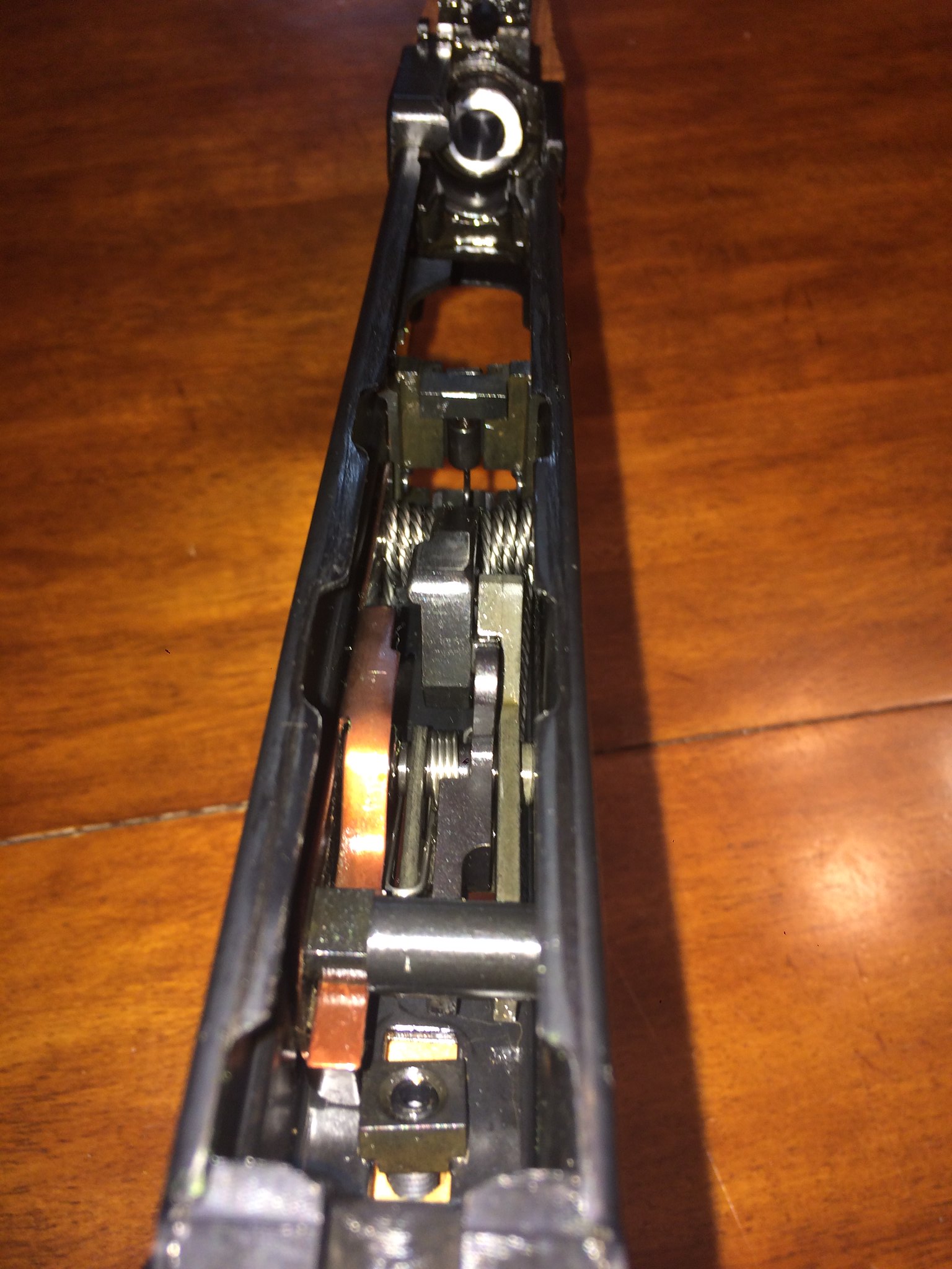

Can anyone comment on this top-down look into the receiver on how much further the screw should be in, if at all?
I drilled mine out so the shaft of the screw is still attached as it was from the factory to the bushing and it’s 100% flush to it. Not looking forward to removing it. I’ll throw it in the oven I use to cure paint to loosen up the thread lock before hand, should help. I suggest you use some heat as well as the threads are problematic with the residue in them still
As part of me suspected, this photo from the Owner's thread makes it clear that I didn't get the screw as far in as it should be. Mine is about 1-2 threads/rotations short of coming through the top. So maybe ~ 70% of the way through? Not sure how much of a concern this is in the long run.
As long as it is tight you should be fine.
