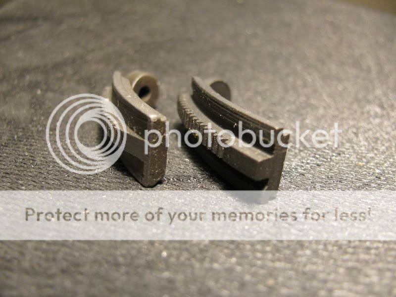

There is a method to trim down the rear iron sight aperture that may get you lower than you are...
M14.CA is correct, I have performed this mod and it works great. As long as you can disassemble and reassemble your Norc sights.
It also works with USGI sights if necessary.
