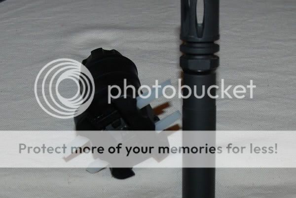

Fist get a thick tie strap and cut off 4 small pieces. You could also use the small square locking thing on the end of the small black straps that come with the grip (I just found the bigger strap easier).
Then fold over the strap, push down one of the four spring loaded bar locking clips, and slip the strap into the space to hold it down.
Do this to all four and it will look like this.

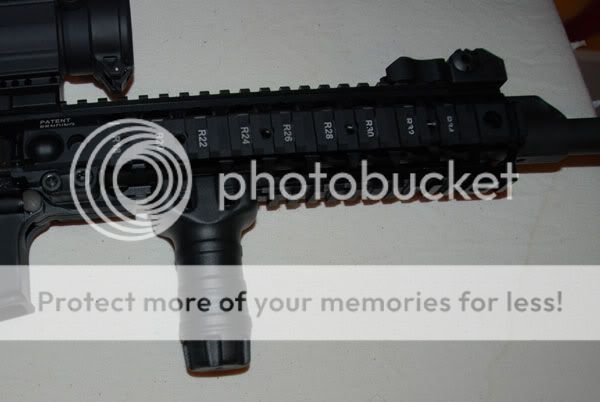

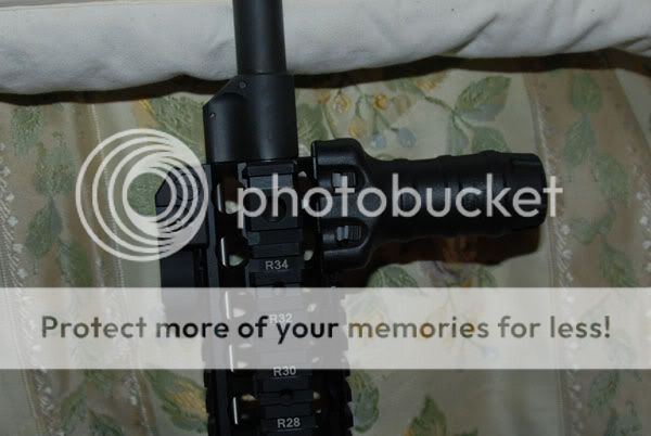

I put a little CLP Breakfree on the rail to help it slide, then got it started on the rail like this.
Then just slide (or hammer with your fist) the grip down the rail to the position you want it and pop out the straps letting the 2 rail bars seat in the position you desire. Looking like this.
