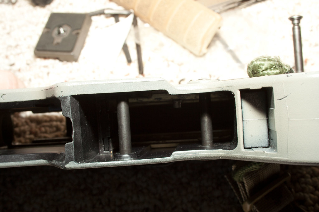

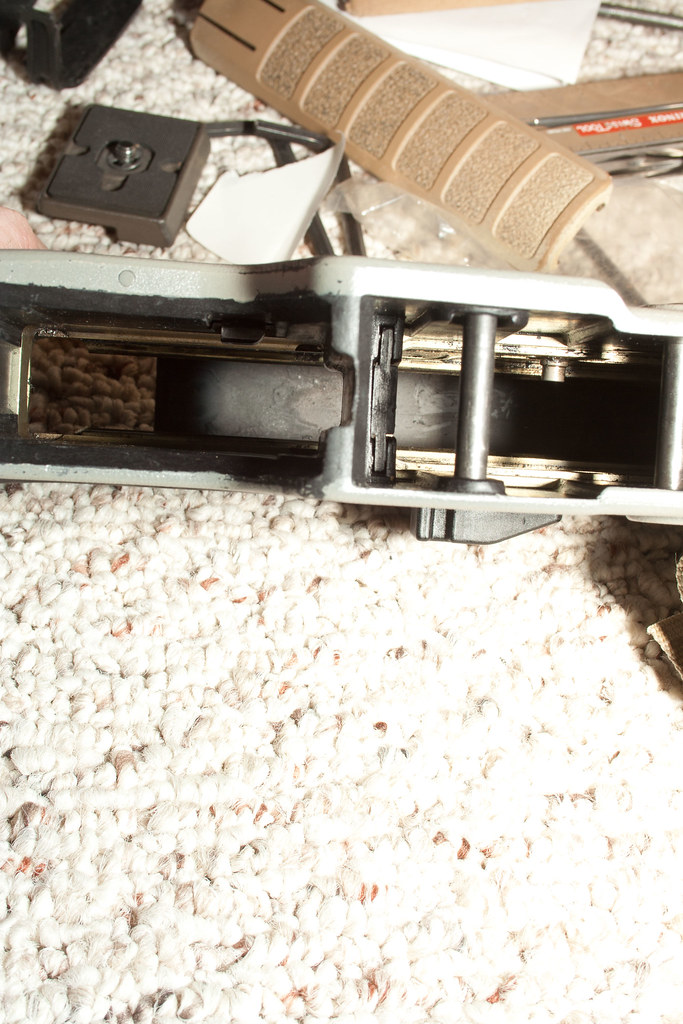

[/URL][/IMG]
old pic, but its the pin just left of the sling hole. Make sure that sucker has its locking pin securely in place. I sure am glad I caught the issue though.

Those trigger pack pins aren't supposed to come out! They're supposed to stay in the gun just like your but stock pin

yeah, I was going to say those pins on the Tavor are captive pins, they are not supposed to come out that easily without breaking something.
The retaining pins that hold these 2 pins in place were not secured properly. I noticed the other one was not seated in its grove when I put the one that fell out back. The gun was in for repairs recently and they may have not properly set the pins in place. I could force them to fall out once they were set properly. And they are a pain to remove on purpose.
