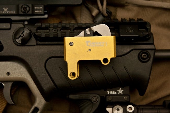

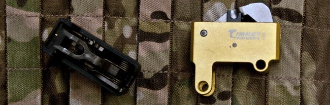

The initial estimate of “shipping in 30 days” was overly generous for everyone. But in the first week of May I did receive my Tavor Timney Trigger. The longest part of the installation was finding a pen in my office to punch the Tavor’s captive pins with. After that, the factory trigger pack drops out in seconds and the Timney locks in place.
I can tell you as a long time Tavor shooter that this feels like a huge difference. I’m happier with this rifle now than I’ve ever been. But happiness is nothing compared to hard numbers.

I’d say those speak for themselves. The Timney is noticeably lighter, crisper, and with a shorter reset. Interestingly you still get an amount of creep from the Tavor’s linkage bar. The only way to remove this from the system would be to produce a new, shorter linkage bar, which would be a substantial challenge for most users to install.
I would be remiss if I did not address reports of early adopters having issues with light primer strikes or unintended slam fires from their Timney Packs. On various forums across the web, owners have had to exchange their triggers or send them in for repair. I was very fortunate to have had no issues whatsoever with my Timney trigger after 400 rounds downrange using a variety ammunition. It is possible that I received a unit with upgraded parts already installed, although Timney did ask if I’d had any issues after the first 100 rounds.

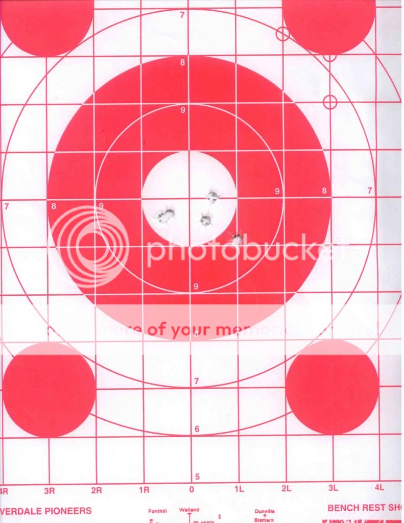

Posted below are my 100 yard groups shooting American Eagle 55gr .223. This is far from a comprehensive accuracy report, but gives an indicator of my personal experience:

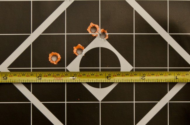

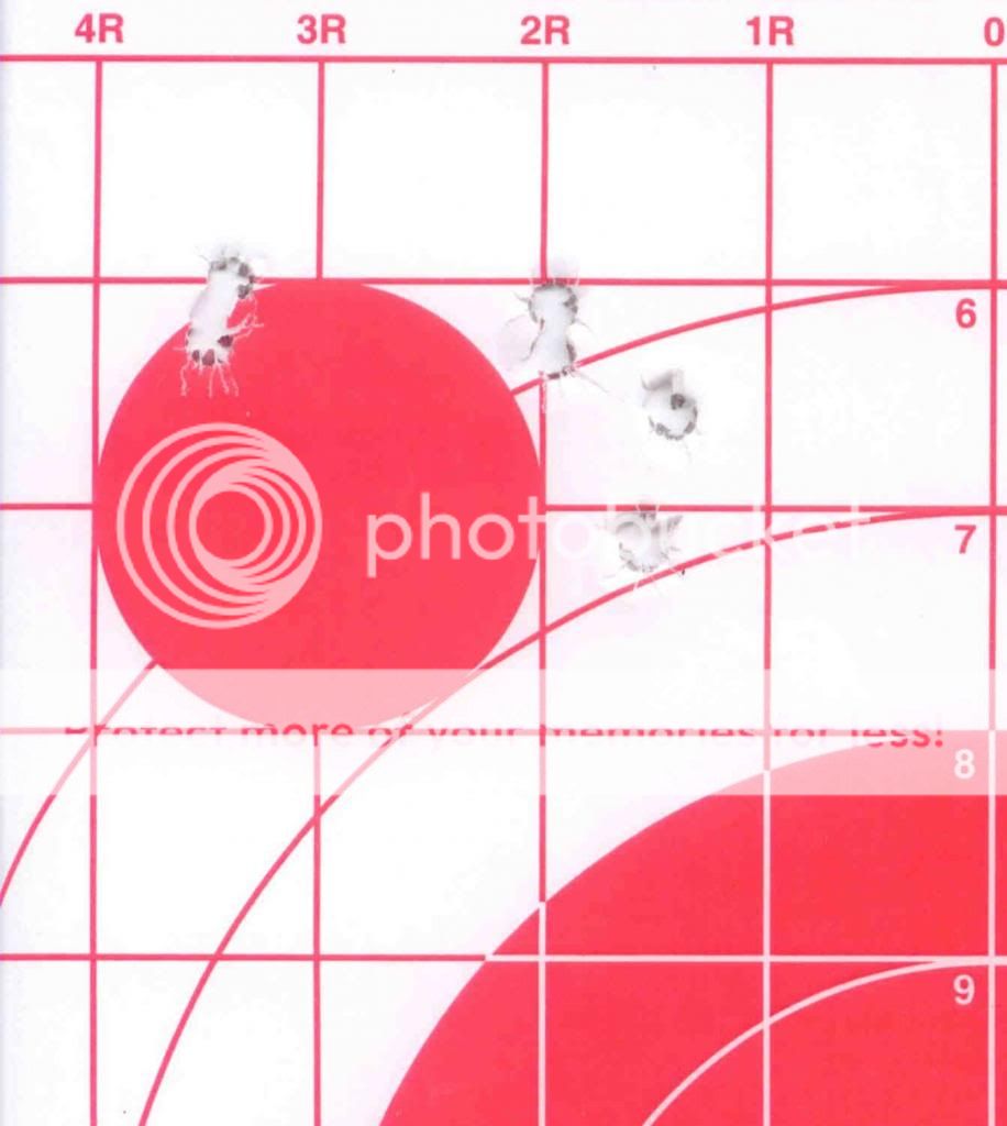

- Timney Trigger
- 100 meters
- 62gr PMC x-tac
- seated position but not supported
- second picture is actually 1st attempt, 1.5 magnification
- first picture is using 6x and was my best result
- there are a few others with varying success .... Never said I was good nor consistent :)
Ya - should have provided more detail.
