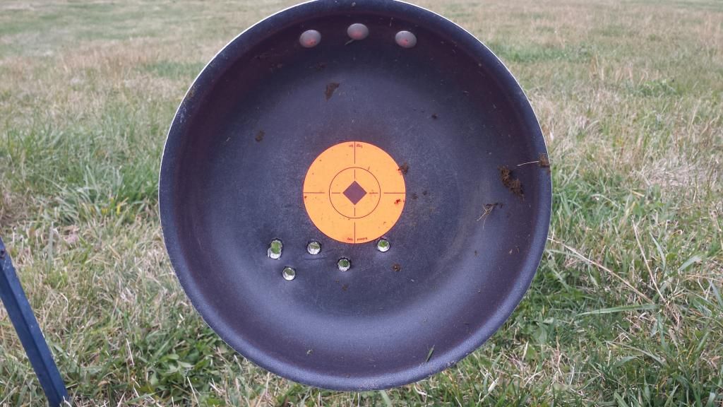

Here is a pic of factory lapua 167gr at 600m.
