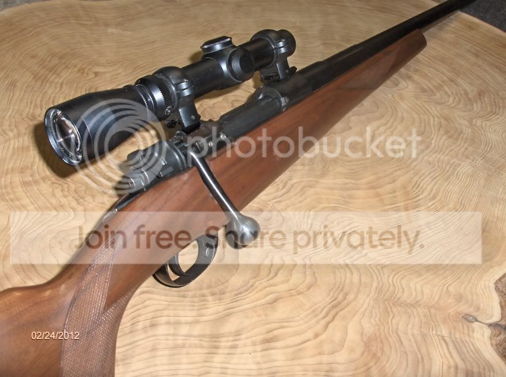

Here's a pic of my 45-70. It started out as a Navy Arms conversion. I then made my own custom long bolt handle and had had the barrel shortened to 20". I also drilled and tapped it, glass bedded the action, added a low scope safety, and Bold trigger. Quite often it will put three rounds touching or very close if I do my part.
Looks good:). What calibre did it start out at, I'm assuming it wasn't 45-70? And if it wasn't already in 45-70, did you have to open up the siderails and/or modify the mag follower?
Hey I have one of those wing safety things...Mauser right?
