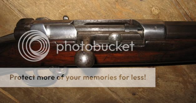

So I offered him $50, we haggled and settled at $75. I took it home and started going through my Gun Trader Guide. I found it, a Mauser IG 71/84 in .43 Mauser. The receiver was dated 1888, Hmmm, a contemporary to my Mk.IV Martini.

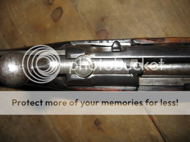

Parts are not that easy to find, so I made some. The bolt has a screw and big fat washer that prevents the bolt from coming right out when cycled. The screw and washer were missing, the screw gets busted easily, it is not meant to be taken right out, it has a pin retainer. Bubba don't know this and just cranked it and snapped it off loosing it and the washer. So I went through my doodad tin in the bottom kitchen drawer and found a bolt that had the correct METRIC thread. I chucked it in my drill press and using a hand file, reshaped the hex head into a domed countersink head. I cut the screwdriver slot with a fine hacksaw. For the washer I took a 1/2" bolt, chucked it in my drill press and reshaped the hex head into the domed washer. Cut it off to length with a hacksaw, held it in a vise, filed it smooth and flat on the back, then drilled and countersunk the front. Took me about an hour and the bolt retention was fixed. Not exactly the same profile as an original, but for not having anything for reference, it looks pretty good and does the job.

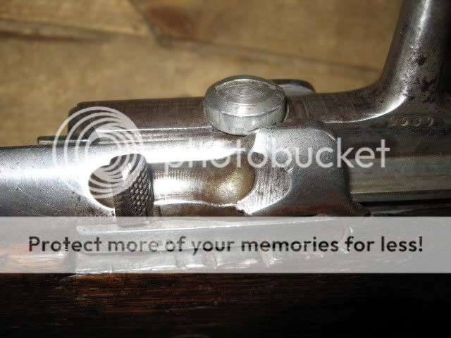

My cartridge elevator was buggered, it was missing the cam, and the elevator cam track was chipped and broken. It was original numbered part to the rifle so what the story was of how it got broken, I don't know, it is a tough thing to hurt.
I posted here on CGN and sang the blues about my rifle. Another collector stepped up and donated some parts that he had in his bin, gratis. Wow! (thanks Andy) I was on my way again, I now had a good elevator to work with.
The cam I made from steel material from a big washer of correct thickness. I had no pattern but found a photograph of an elevator cam on the net. Comparing it to the track it had to ride in, I printed it to scale. I could then take dimensions from my print. Took one evening and two attempts, but I got a hand filed cam fashioned that worked.
I changed it out for an original cam that I just scored. Pic shows my hand made one compared to an original. Pretty close I think.

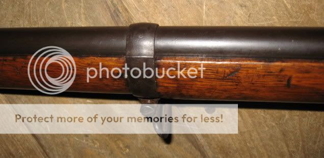

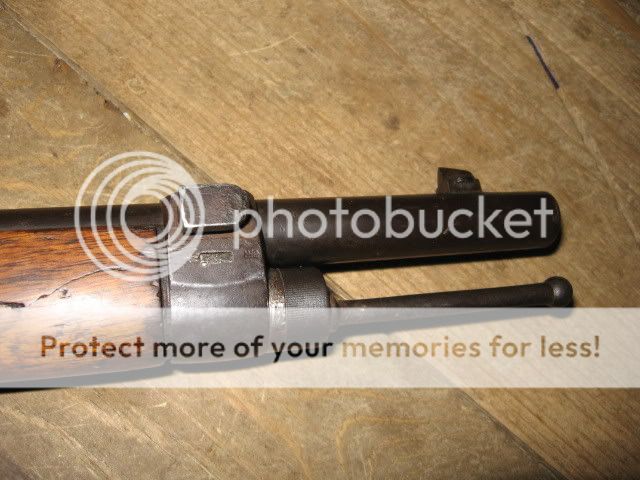

The bayonet lug had been shaved off of the front band, maybe to make it less 'military'?. A shame really cos it was a matching numbered part. The middle band swivel screw had been busted by Bubba. Similar to the type of screw used on Martini sling swivels, there is a captive nut fixed on the end of the screw. To tighten the band, you actualy turn the screw OUT. Bubba don't know this and cranked the screw till it busted, and lost the swivel. I got chatting with a chap stateside who bought a bunch of rifles that were found in a cave in South America. Apparantly they had been stored as an arms cache in Equador. He sent me a pair of barrel bands gratis! I cleaned them with fine steel wool and oil and bingo! Their patina matched the rest of the hardware.
