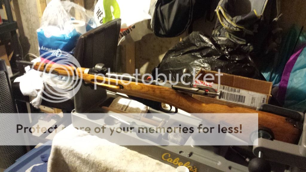

Here is a M38 I fixed, shoots great. My mistake was using a clear adhesive, another time i will make a sawdust/glue slurry then apply so it fills in the space. Still I am happy with the result and it is a 3" rifle at 100yrds.
Looks good. How long did you let it sit before mounting and testing?
