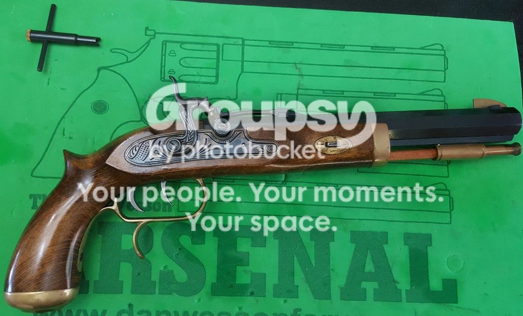

I was going through a box of jackets that my father had put aside for me before he passed and to my surprise it contained more than just jackets; inside I also found a Traditions Trapper .50cal black powder percussion pistol. I spent a good hour on the phone with Miramachi this afternoon, going through the steps to get this gun registered. The nice woman verified the gun over the phone and walked me through going online and requesting a registration, so now it is hurry up and wait. I guess I now have some reading to do to figure out how to enjoy shooting and maintaining this gun, plus where to find supplies (this is the fun part anyways).
Nice find. You'll like the Trapper. I've got one and it's a great shooter. 30 grains of triple 7 and a .490 dia. round ball and #11 caps (I prefer CCI's). Enjoy!
Excellent pistol but try about 20 gr FFFg real black powder with a 490 ball and lubed light denim patch. CCI #11 caps are perfect. #10 caps are for cap and ball revolvers.

From my own testing I started out at 20 on a couple of single shot pistols and worked up to 30 where they showed a big improvement in consistency and accuracy. I still need to fine tune things but the point is to stay flexible and find the sweet spot for the barrel and projectile. Hell, even the patch fit matters it seems. In one case I went from "minute of hillside" to truly a small circle of error just with a patch material change. So stay flexible for now and try a bunch of options for each aspect.

You've got a powder horn already so really you only need a measure. You can certainly buy them and in fact the last time I was up there Rusty Wood had the popular stick style measure with the adjustable piston and fold away funnel on the wall. He also had a variety of cappers that make handling the caps and putting them onto the nipple a much easier and tidier task if you're not shooting from a bench.
Speaking of your first trials from a bench setup. I suggest you bring along a towel that is large enough to lay out and place all your loading goodies on and still be large enough to fold the towel over the powder horn and caps. With a flint lock this is pretty important as there's a shower of sparks. But cap rifles and pistols tend to toss out at least SOME sparks from around the cap and the last thing you need is to have one of those reach the powder in your horn or flask. So a towel to cover up the stuff before you shoot is not a bad trick IMO.
One of the few things that I've done a bit differently for my single shot pistols is to make up a combination ram rod and ball starter that is similar to a regular muzzle loading ball starter but with a longer ram rod that lets me fully ram the ball down onto the powder in the pistols. I use this instead of the ram rod that comes with the guns just because it's easier to use the one tool than fuss around with separate starter and ram rod. I used a section of antler and wood dowel for mine but the same thing can easily be made from hardwood for the handle and regular dowel for the ram rod. A branch cutting from a hard wood tree that is around 1.5 inch in diameter would be dandy.
