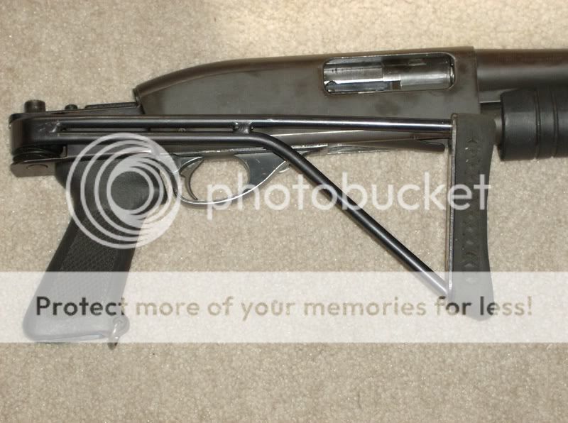

OK, a while back I purchased a S&W 3000 from a board member here for a very good price so I decided to make it my project shottie. The shotgun was functional and everything but it just looked used, so I decided to bring it over to Striker to see if he could help me out.
Well, he did....

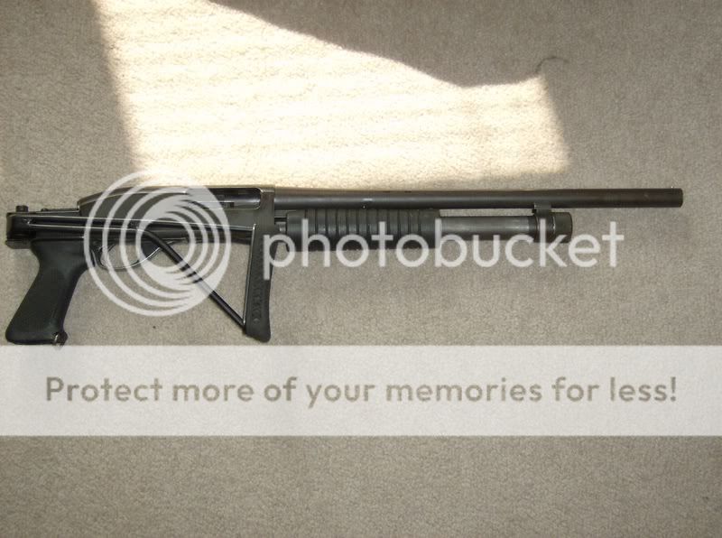

Before:

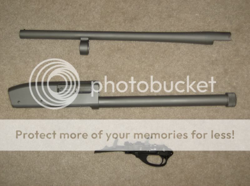

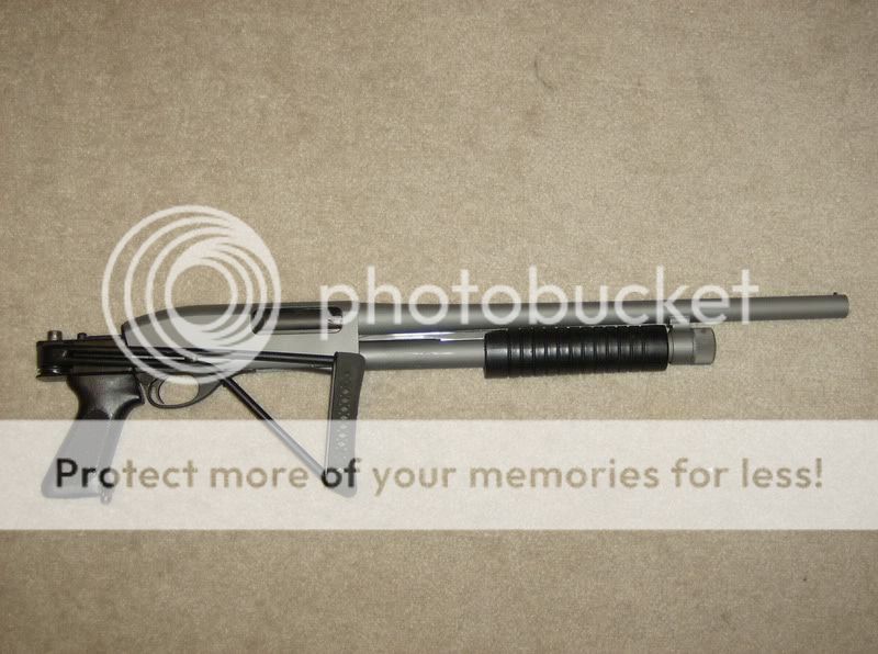

After:
The new colours are Flat Black for the trigger assembly and Titanium for the rest. The stock I painted myself, just so it would match....I'm getting a Mesa Hightube Stock for this one.
Not only did he do a very good job at making this once dull shotgun look great, but he even went as far as checking back with me a few days later to be sure that everything went ok with the reassembly.
Thanks Striker :rockOn: :rockOn:
This was the first gun we refinished in titanium. Luger9 picked it out and we ordered it in.
I like it a lot more then the brushed stainless I did my Taurus frame in.

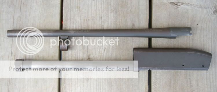

Hot damn... I like how the S&W3000 has the ejector pinned in place. Excellent idea. Are the latches staked like the 870 or done another way?

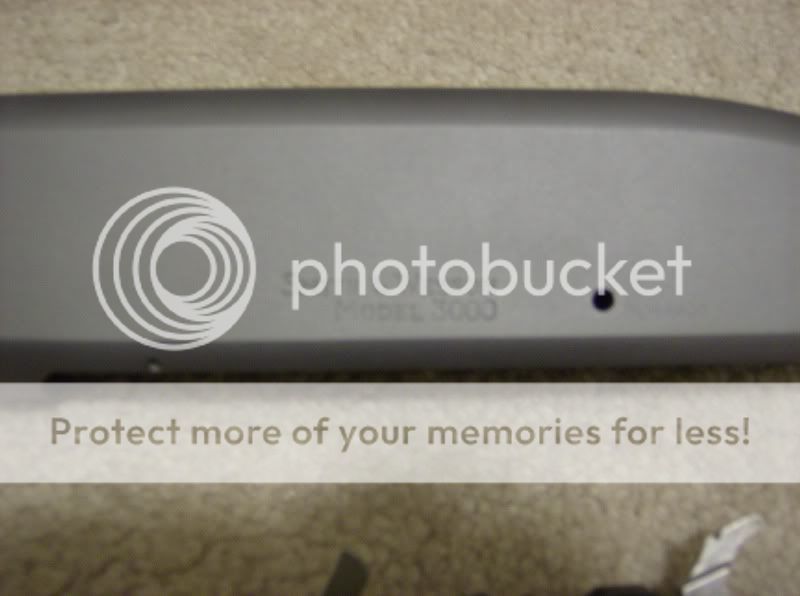

The shell latches are completely different then an 870. Where the 870's are flat spring steel, the 3000's are stamped steel with a spring between them and the receiver. They are held in place by pins that run vertically up through the receiver wall.
You can see the hole for the pin in this pic.
Much like an Ithaca 37
