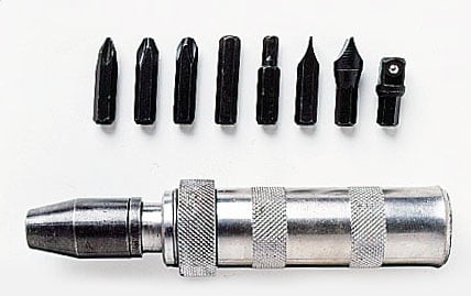

An arbour press putting downward pressure on a screwdriver while it is carefully turned with a wrench will keep it from lifting out of the slot. You can also try an impact driver, the type that is hand held and struck with a mallet. A well fitted screwdriver tip is essential.

An impact driver is the best tool for non-destructively removing screws.
You hit the end with a hammer and it turns a fraction of a rotation. The shock of the impact and the torque multiplication involved works on most stubborn fasteners.

Most slot head screw heads are ruined because conventional hand screwdrivers have a taper toward the point rather than parallel sides. The hollow ground screwdriver inserts pictured with the impact driver have parallel sides where they engage the head of the screw. The impact driver can be reversed to tighten or loosen by turning the top one way or the other while holding the other end. Check whether it is set to loosen or tighten by tapping it on a flat metal surface like a bench or vise without a bit inserted. To use the impact driver, hold it tightly twisted counter-clockwise in the screw head, then give it a smart whack with a ball-peen hammer.
Impact driver for sure. It will 100% get that screw out and rarely makes it worse.
And they're cheap. You can get them almost anywhere, Canadian Tire should have one.
If you have a set of precision tips, you can put the socket on the 3/8 square drive of the driver that fits the hex shank on the bit. Works really well.
