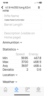

New Load 62gr Hornady ELD-VT
I have some new load information. I think I found a keeper at least in my rifle. At nearly 3700 fps I think this will destroy gophers and coyotes alike. SUB 1/2 MOA and SD of less than 10 fps
This is a varmint hunters dream !!! SO excited to test on a critter or two.
Powder is 41.9gr of H4350
COAL is 2.640 (right out of hornady manual)
Bullet Hornady 62gr ELD-VT
Gun DATA Posted previously on this thread
PLEASE TAKE NOTE THIS LOAD IS FOR MY RIFLE ONLY AND MAY NOT BE SAFE IN YOUR RIFLE

Sorry I posted the gun data on a different thread so I post a photo or two. Its the same rifle as my 6.5 Creed pictured hear but with the 22 Barrel
