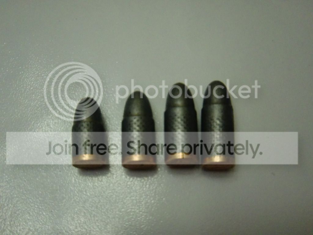

Swaged some bullets today, 10 of each weight just to try, 180, 200, 220 and 240 grain. swaged them with a gas check on the base and then knurrelled and tumble lubed in my special lube. Loaded them all up seated far enough out of the case to hold the base of the case back on the bolt face, going to keep my low pressure brass separate from my full house loads and bump the shoulder forward to keep the primers seated flush in the cases after firing

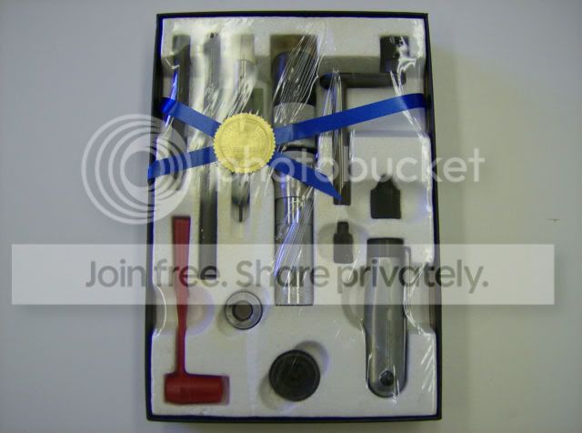

But some may find this interesting, a Lee Target Model Loader in .35 Remington. It's got a micrometer seating die.
