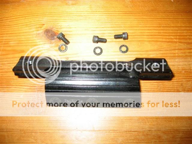

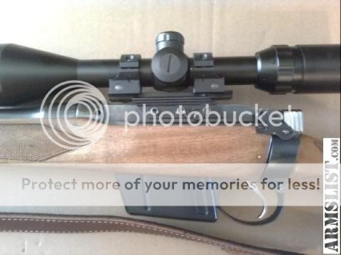

these are the three variations of scope mounts offered by PH for their rifles

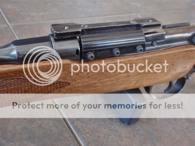

this is a A27 for custom no.1, takes low rings
side of custom no.1

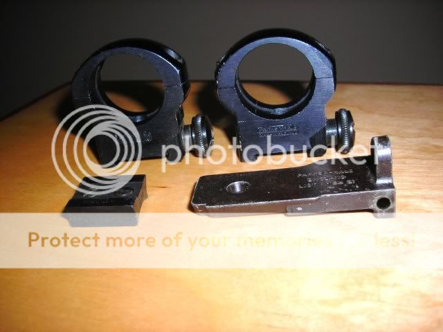

this is the 20/21 setup for no.4 actions (mostly seen on the supreme no.4 and de-luxe no.4)
that were D&T for the front base block, takes high rings for scope to clear the rear aperature, you will see some with aperature filed off to allow for low rings
small block is the 20 , rear that replaces the military sight is a 21, RAHS3 rings

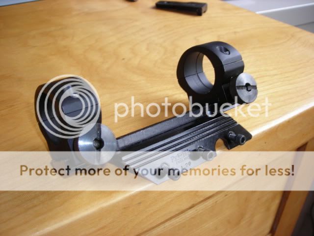

this is the A29 specifically for the rare custom no.4, takes low rings
installed
** the side mounts for the custom 1 and 4 were actually a bit flimsy and I think would probally not hold zero if knocked around much,
the 20/21 set up on the other hand is rock solid and the best of the lot in my opinion**

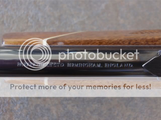

MARKINGS

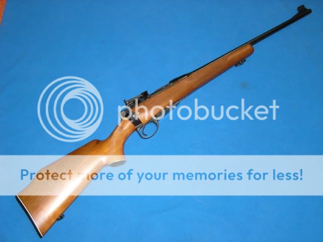

That's a neat idea. I'll post some pictures of my mint Standard No4 tonight on here hopefully. From what I've seen most of the higher end conversions were at least semi custom. There are pieces from different variants on each seams like. I love mine, best shooting rifle I own. Its only ever had about 60 rnds through it in the 35 years it has been in the family.

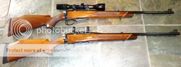

My experience....

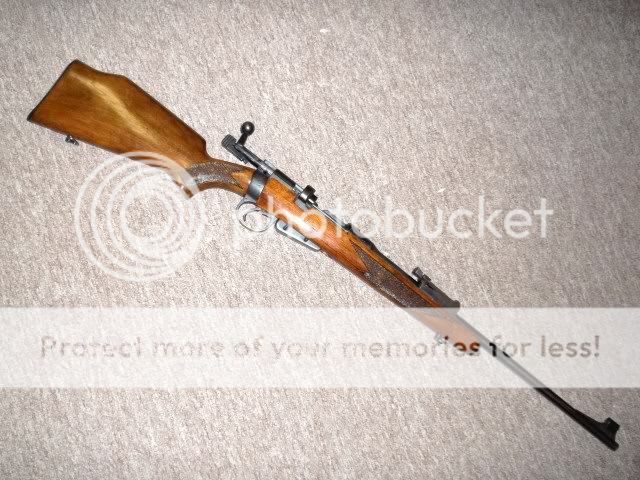

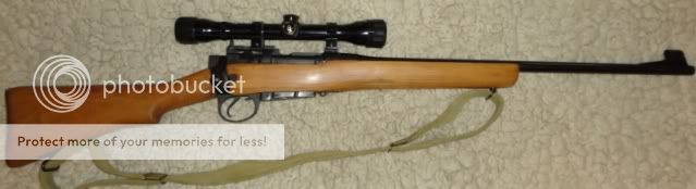

Parker hale No 4 Supreme (Ex Maltby No4Mk1 1942) Shot very well but was not so pretty...

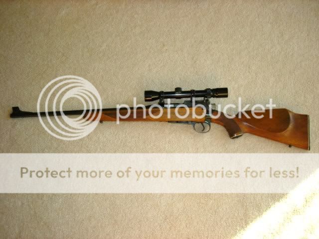

Parker Hale No 4 supreme (Maltby No 4 mk1 194? convert to No4Mk1/3) Pretty wood very good shooter.
Top rifle is short in the butt length (Cut) was like that when I got it... Front sight hood if not correct. but good shooter
Bottom has correct front sight hood.
I might add the bottom rifle has a No1MkIII* mag, it would not load well with a No 4 mag,...go figure

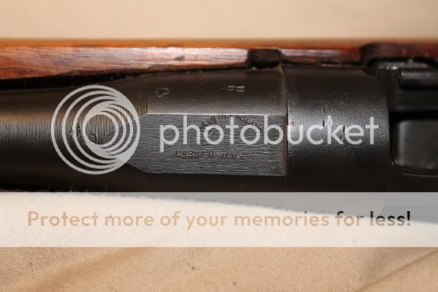

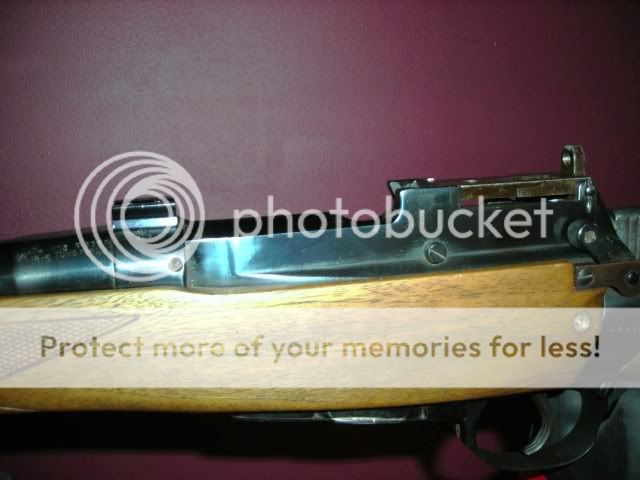

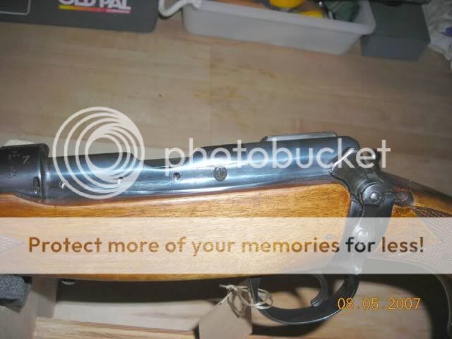

Some Parker Hale 303 converts have the "Parker Hale, Birmingham, England" roll stamped into the barrel (Custom No 4,. Custom No 1). Parker Hale never made 303 barrels............Ever......... re ground, cleaned up, re blued, roll stamped, etc yes..
A Parker Hale 303 Sporter will have the following

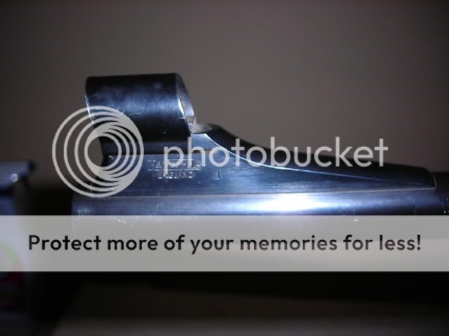

Parker Hale marked front sight
PH will be stamped (often but not always) under the bolt handle on the receiver... pict to follow.

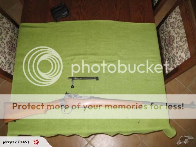

All makes and mods were used to make PH 303 convert..
Lithgow convert No1 Supreme
