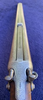

Speaking of Dougall, here's a 'Lockfast' 16 bore double rifle with polygonal rifling. Fitting barrels to action on the Lockfast must have been a painstaking process requiring plenty of time and great skill. And then it had to be regulated!
Beautifully made, but I find the action not as convenient or quick to operate as more conventional types.
Polygonal rifling.
Action - note semi-circular projection at upper standing breech that fits into the cut-out at the end of barrel rib shown below. Similarly, that projection under the barrels fits into the bottom of the standing breech for double the security!
A seamless fit.
Still shoots like a charm!
