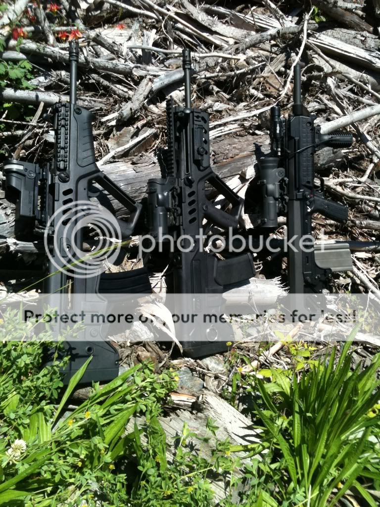

So I think I understand the fundamental purpose for this type of flash hider, but does it only benefit SBR's? The reason I ask is I'm thinking of trying one out on a Tavor bullpup, but I'm not certain if it will be advantageous in any way. The Tavor has an 18.5 inch barrel but the overall length of the rifle is only about 27 inches, so is it barrel length or overall length that the Noveske Pig will benefit?
Thanks in advance for any info
