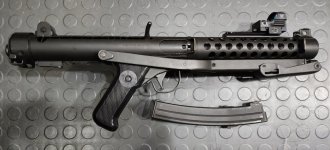

I came across this video on YouTube about the accidental discharge of a C1 SMG during the 1970 FLQ crisis, killing a soldier of the RCHA ,
I’m sorry , I’m not computer savvy enough to send the video over from YouTube to CGN
I quite like the C1 SMG for what it is, which is a quite refined 2nd Generation open-bolt SMG employing advanced primer ignition. So long as the provided safety devices are properly employed along with safe handling drills, the C1 SMG is a very safe firearm. Unlike, say it's predecessor the STEN Mk II, which was notorious for accidental or negligent discharges....
The issue with guns like the C1 SMG is usually operator error. My dad told me about one guy in training who got confused and decided to try and close the bolt on it with a round in the magazine and had a negligent discharge because of it.
Here it is. Sad story.

I used the C1 SMG in 1980s in 1 RCR on the SMG competition team
trained all summer NO NDs on my team
it was perfectly safe when used as trained
if the bolt is put forward first NO mag in , then loaded mag inserted
and safety is on it was not a problem. We only cocked it when ready to fire
It had a 3 position safety S
R (repetition) and A (full auto)
always MUZZLE CONTROL Finger off trigger
of course as it was open bolt SMG it would climb high right when on full auto
so we trained to fire 3 round burst "son of a ##### "
Actually on R (semi auto) we could hit a figure 11 at 100 yards I was amazed.
it had adjustable sights so it could be sighted in
and we had a team weapons tech with us
Big improvement over the STEN

I trained on them in the 80's as well. I liked them. Simple, rugged, accurate enough for purpose, handy to carry. One ND on the firing line but attributed to operator error between controlled three shot bursts. Mag was emptied. Good thing muzzle control was maintained. We had them in ship's armoury on HMCS Assiniboine.
That video is silly.
The sad truth is that the deceased had an accident and it killed him - (as I understand it), there was nothing actually wrong with the gun - if the safety had been applied - the incident wouldn't have occurred.
The interesting thing is that I've heard for years that the incident resulted in changes to the C1 SMG, but I can't find CFTO (I don't have all of them) reference to any actual change.
There however is one of the springs which is dyed red, usually a sign in the CF of a spec change, or replacement spring weight - but I don't know if/when there was a replacement program.

The stem mk2 was a perfectly safe if the safety is used. Alas, many users carried it with the safety disengaged.
The safety of a mk2 is applied by pushing in the cocking lever, making it impossible to move the bolt.
While this is true, remember that the push-through safety was a retrofit. I don't know what year it was adopted but the majority of Sten guns were made without that feature, and it was added later by field armourers. It wasn't always available, and many men trained before it was there.
Before that, there was a very positive safety hook in the bolt handle raceway, which again, was not always used.
The STEN was designed to be dog $hit simple to make and use. Admittedly it had its weaknesses, but I have only handled one never fired it. On the other hand, I carried and fired the SMG 9mm C1 many hundreds of rounds. The safety is very reliable. S for Safe locks the bolt in place. R for Repetition is single shots. A for Automatic for giggles.
The story about the soldier shooting himself makes sense. Loaded mag. Jumping out of a truck. Change lever not on S, well s#it happens. Sorry.
