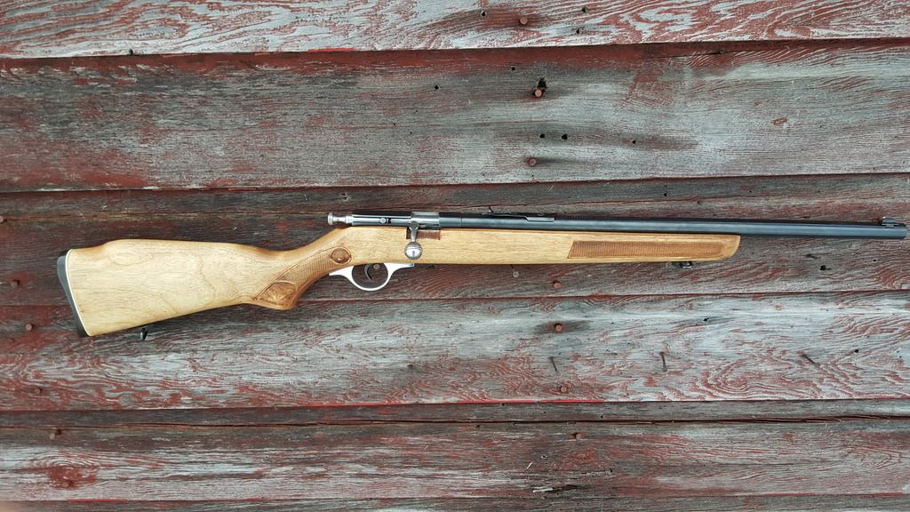

With this in mind, I picked up a well worn model 60 at one of the local gun shows last year planning to give it a respectful makeover. I was able to clean up the stock and it came out pretty well. After a few trips to the range it became clear that it just wasn't a great shooter. It slowly made its way to the back of the safe.
Closer examination this spring revealed that the barrel seemed to have a bit of a curve to the left, like someone had used it as a pry bar or something. I'm sure they had their reasons....
With the front sight drifted about half way out of the dovetail, I could finally get some shots on paper but grouping was minute of dinner plate. With a trip to the bench vise, a less than gentle "adjustment" was made to the end of the barrel. The next trip to the range confirmed that it was now straighter and I was able to drift the front sight most of the way back into the dovetail. Grouping was still no screamin' hell though.

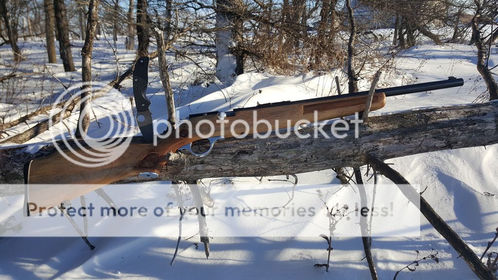

Now, what separates me from the the average Bubba is the fact that I have a conscience as well as a sense of history. I thought long and hard about reaching for the hacksaw...
What would the original (probably long departed) owner think if I sawed 5 inches off the barrel? I heard no objections from the great beyond, so I wrapped the barrel in masking tape and got busy.
Filing a new dovetail was not actually as scary as I had expected, similar to what I had seen on youtube. With the front sight in place it no longer had that sawed off look. Filing the end of the barrel flat (more or less) only took a few minutes. A little bit of cold blue made it less obvious.
Encouraged by the new look and compact handling characteristics I set out to find a Weaver #2 mount as the receiver was already drilled and tapped for it.
I was at Sail in Ottawa looking for something else when the kid at the counter asked if he could help me. I decided to give him a test............kids these days....they think they know everything.......
I almost fell over when he returned from the back with exactly what I needed on the first try, mount and side mount rings. Maybe there is hope for future generations after all!
The following weekend was the big test. The iron sights needed a little tweak and were acceptably on target, then on went the cheap 4x pellet gun scope.
I didn’t want to spoil it by sighting it in with expensive ammo so I got it dialed in with Remington Golden Bullets. I’m glad it likes the cheap stuff!
