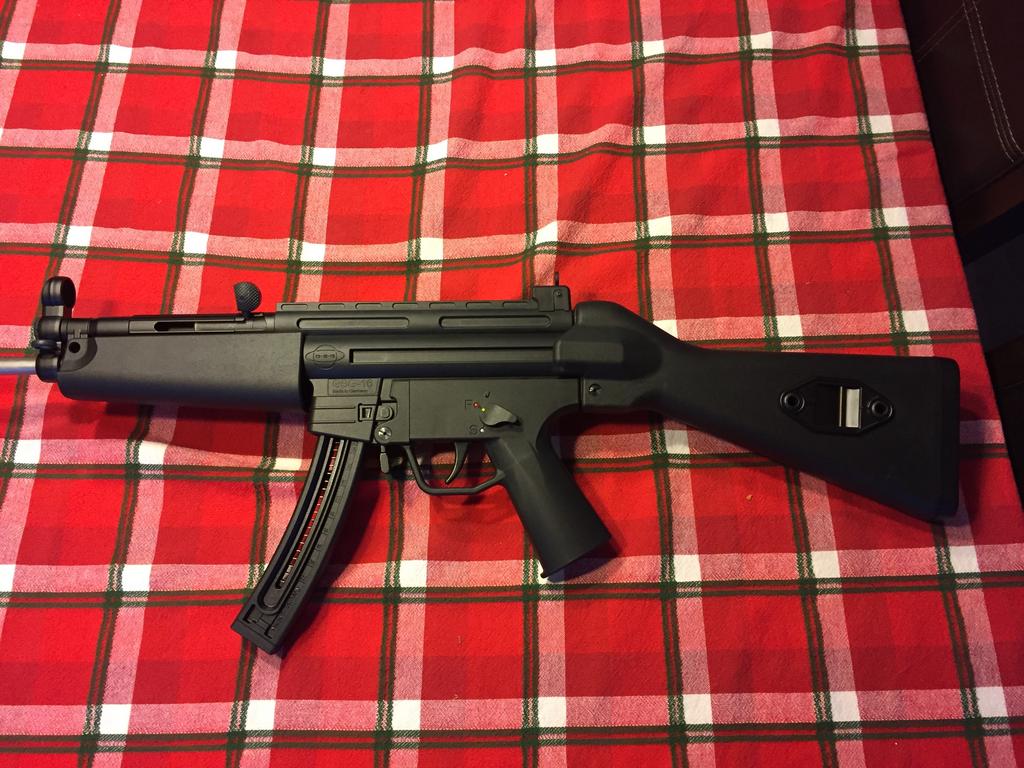

Here is what it became after adding the GSG kit I got from IRG.

The CYMA are the butt stock and front grip. With the old guard was removed, the new guard front supplied push pin lines up to the new GSG 5 cocking tube. I trimmed a small amount of the inside grip moulding then used a bit of glue stick to match the receiver contour to be super snug but I was just being OCD.
The front and rear stock upgrade completely changes the feel, and the metal cocking tube makes it less chessy.

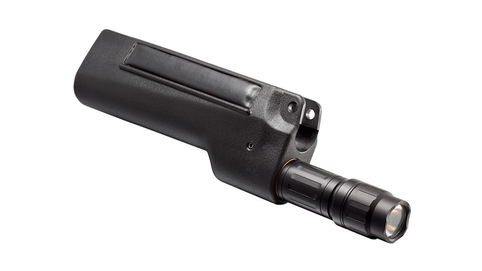

Got my conversion kit in today. Unfortunately the lighted forearm doesn't fit with the OEM barrel shroud. Light is too fat, and hits the shroud. Will fit once I get the short barrel.
fantastic to know! i was gonna order the airsoft one but ill hold off now.
Im keeping the barrel as is. The kids want to shoot it so ill keep adjustable stock for now.
do you know of any forearms with lights that would fit the shroud?
If you can get one with a flash light head of say 30mm, It should work with the factory shroud.
Something like this? It just looks like a standard CR123 battery flash light.
