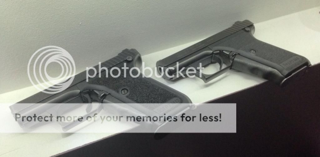

It's smaller than it looked to me in pictures. Here is is compared with a Glock 19:
Despite having a longer barrel (105mm and a bit, compared with 102mm) the P7's slide is noticeably shorter.

The P7 is slimmer, too, although the butt is a bit longer. The grips have a bit of a palm swell, too—from pictures I'd figured they were mostly flat panels but they're well-shaped.
The cocking handle is nicely stippled. I was thinking that the P7 might have the same grip characteristic of the P9S—I find the grip on the P9S a little long front-to-back—but the P7's is very comfortably proportioned. The plastic grips have a stippled texture and a bit of a thumb rest.
