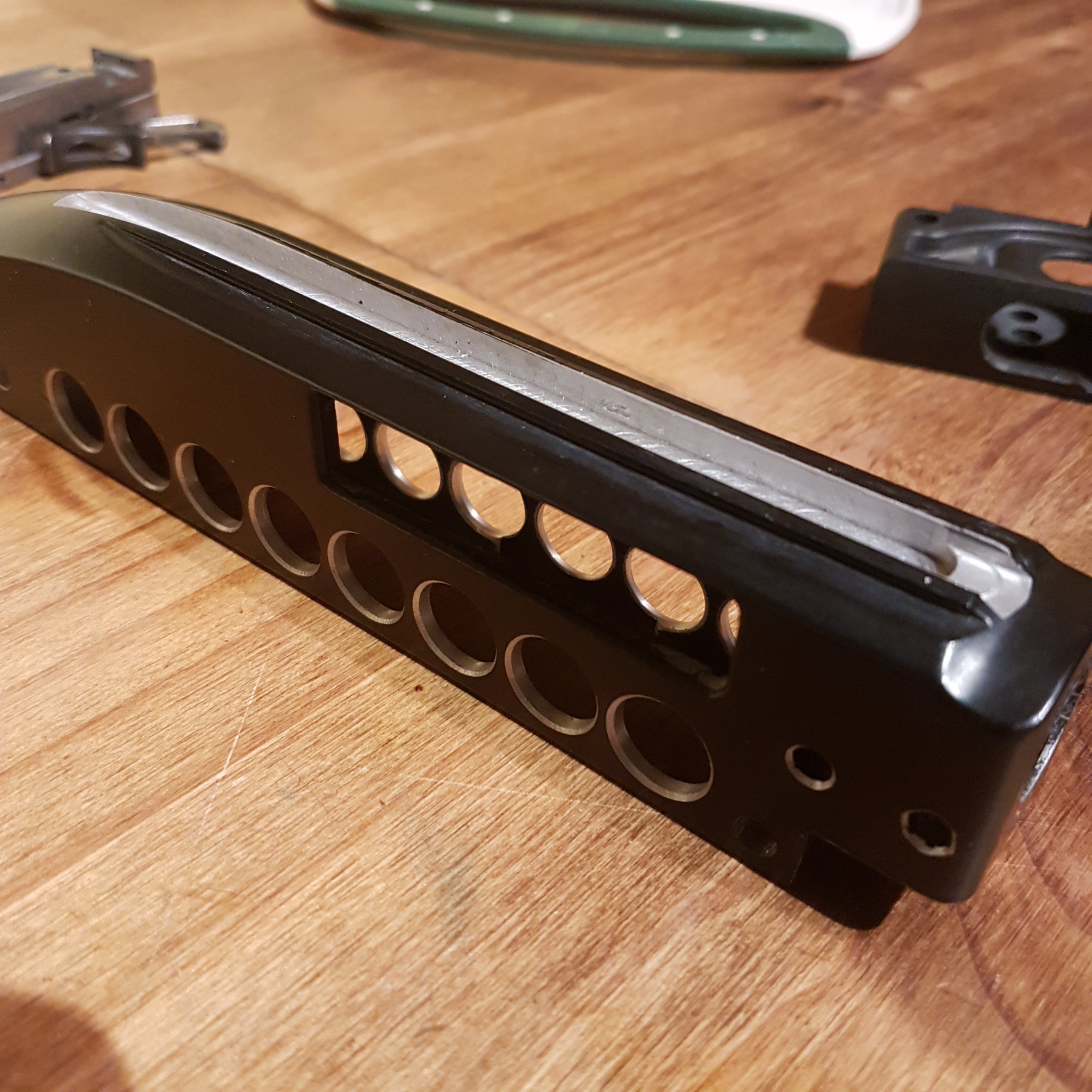

i kicked around the idea of an old cooey 39 lightened up, or buying something like a ar7, then i seen this little mossberg 702 youth in the back of my safe that i had put a 10" barrel on while ago.
it weighed 4 pounds from factory, a little less with the shorter barrel but it was bigger diameter so pretty close

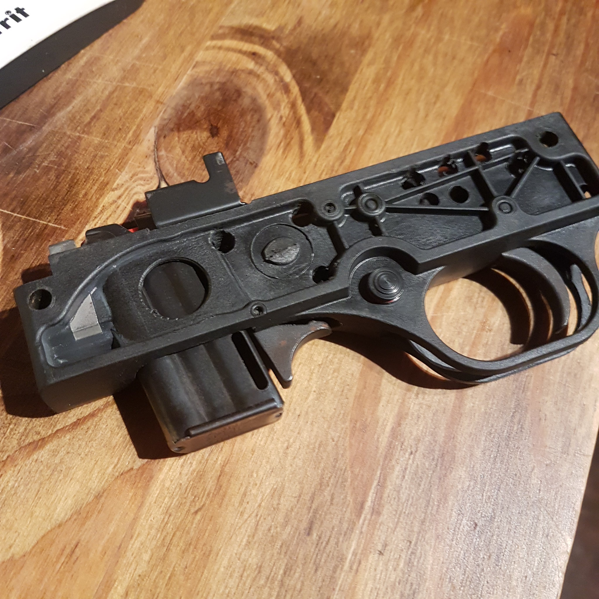

i took it apart last night to see where i could save weight. made a game plan in my head then took it all to work this morning
what i ended up doing was,
-changed pins for roll pins
-shortened the mag to 7 rounds to make it more stream line with the rifle (lighter too)

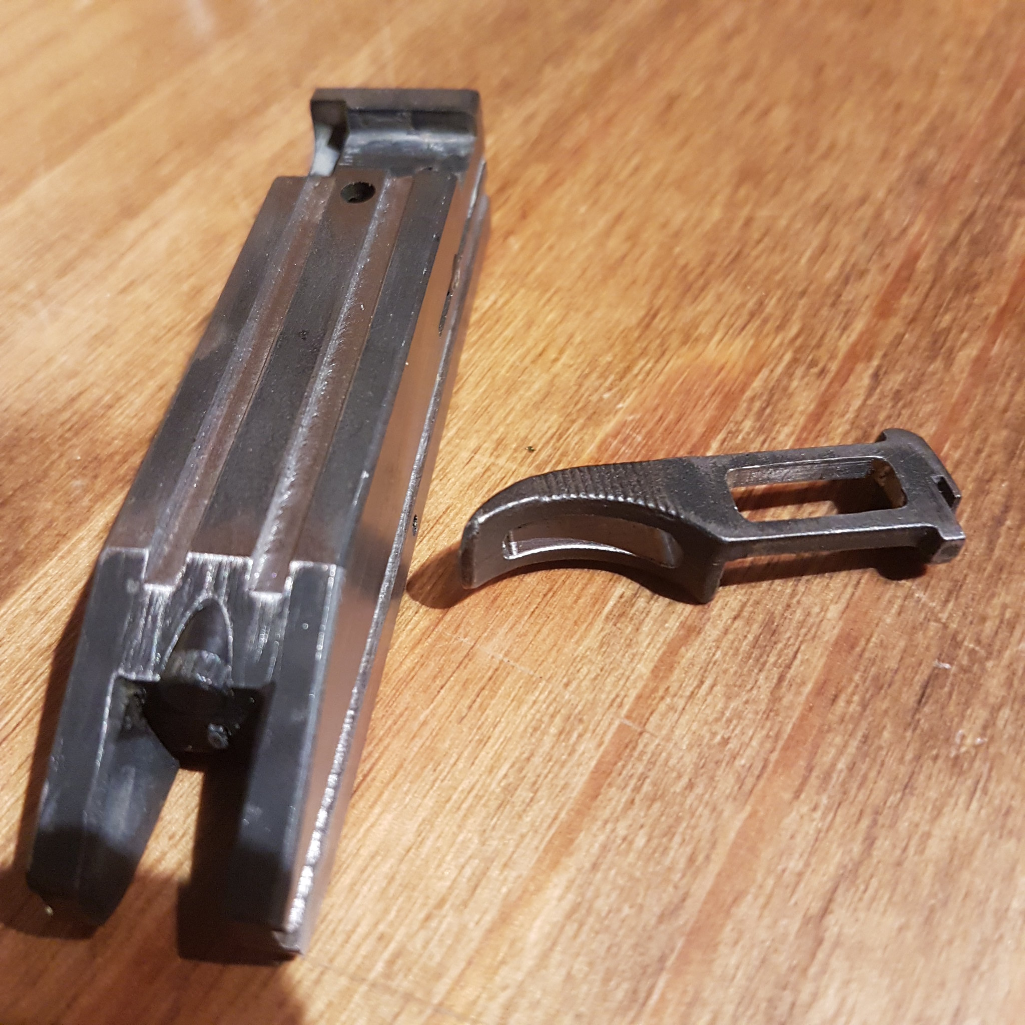

-made four 3mm wide 1mm deep cuts into the bolt
-removed what i could from the bolt handle
-turned the barrel super thin, just in front of the receiver its 12.5mm and tapers to 11.5mm over 9" (1" tenon)

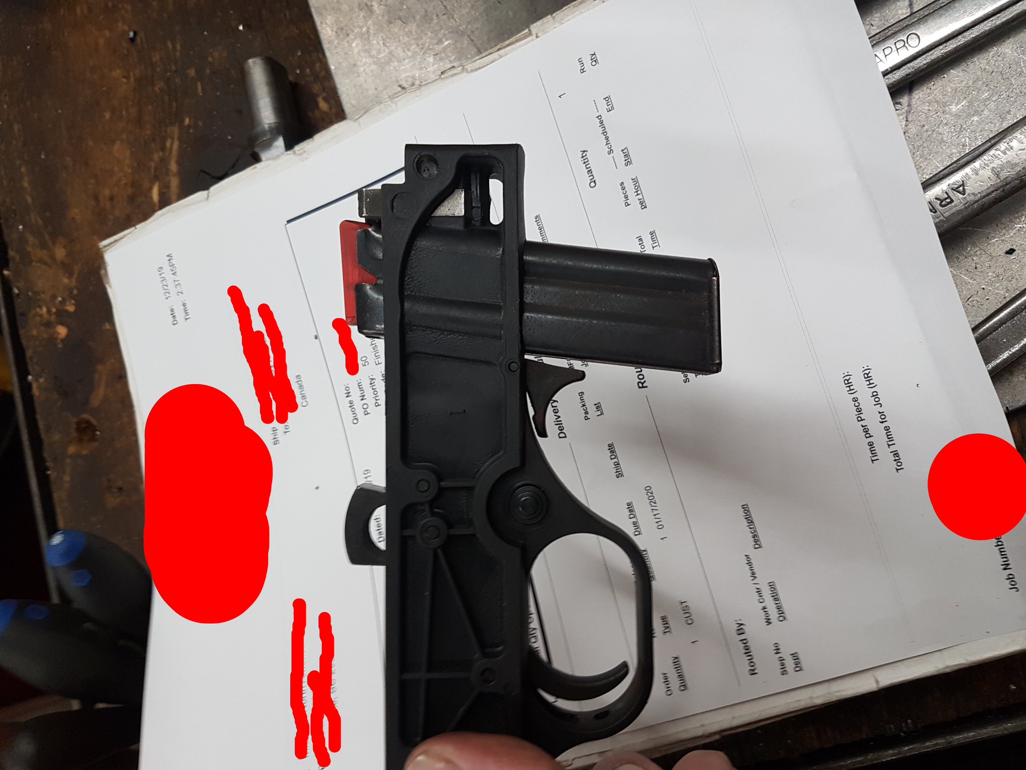

-skeletonized the trigger guard/assembly
-removed a 8mm wide 4mm deep slot from top of receiver
-machined 1/2" holes in receiver below the stock line
i would have put more holes in the receiver but i didnt want to let any dirt in anywhere that wasn't already open.

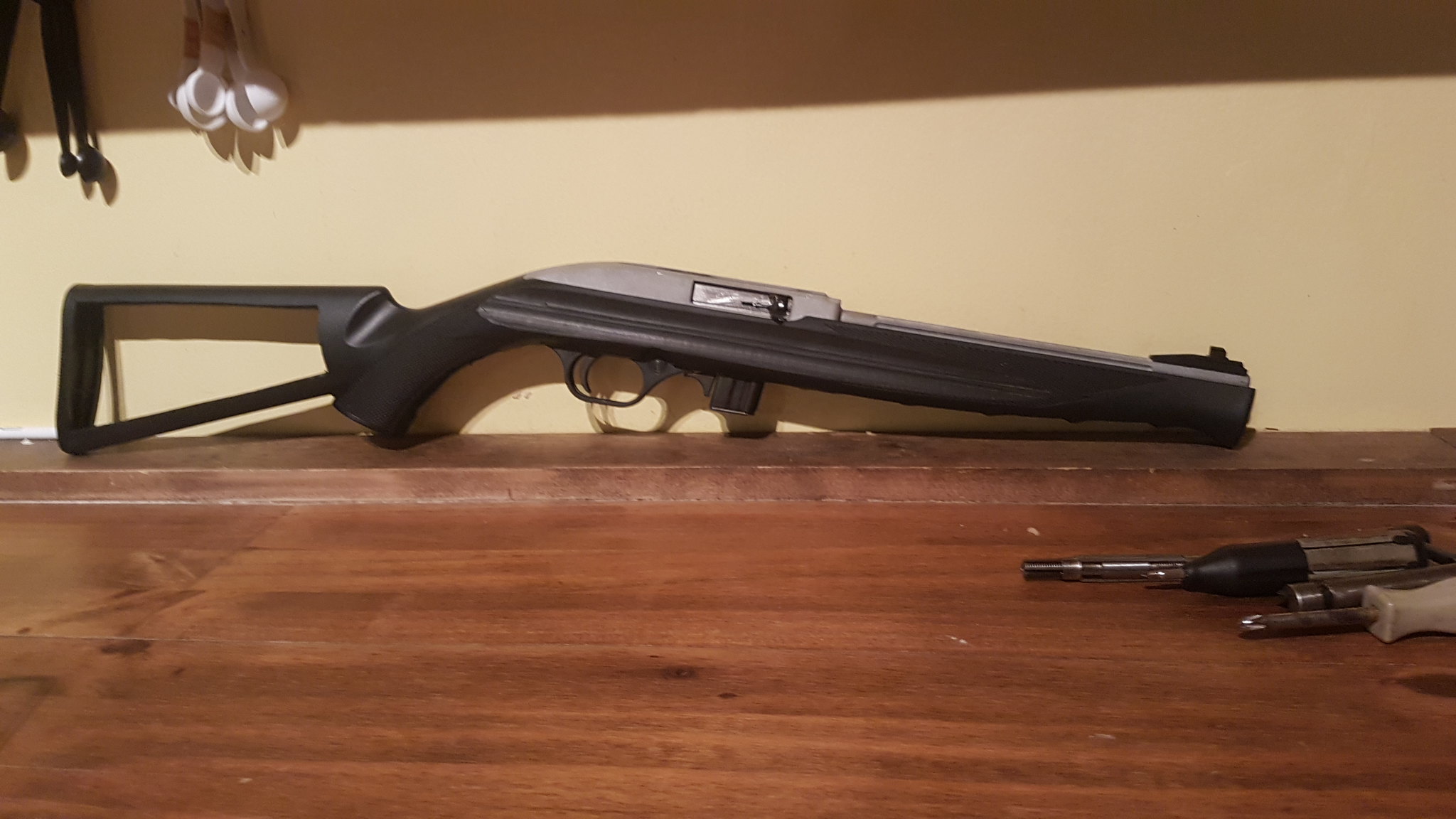

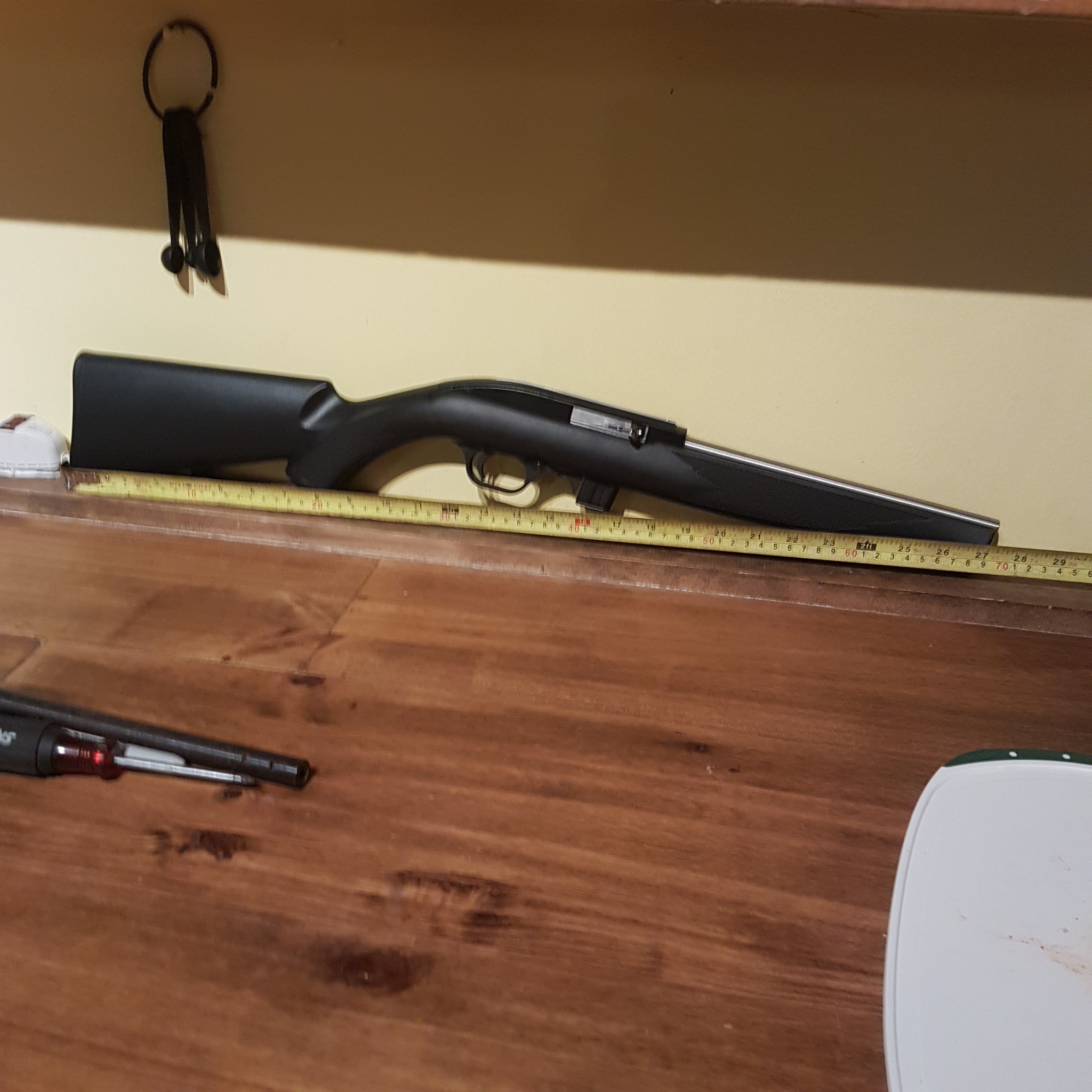

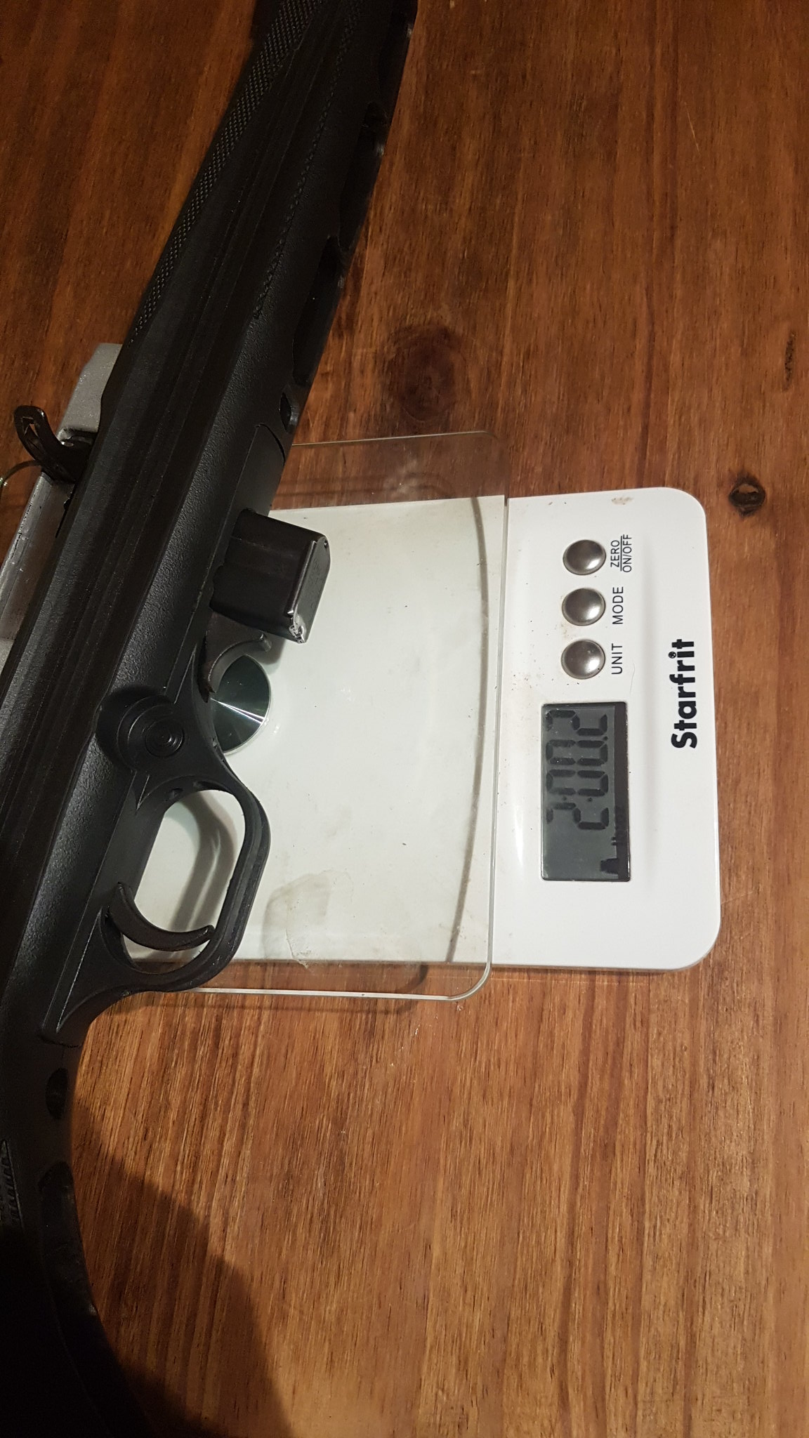

it is 27" long with a short lop of 12.25" but its not so bad with the shape of the stock and lack of recoil

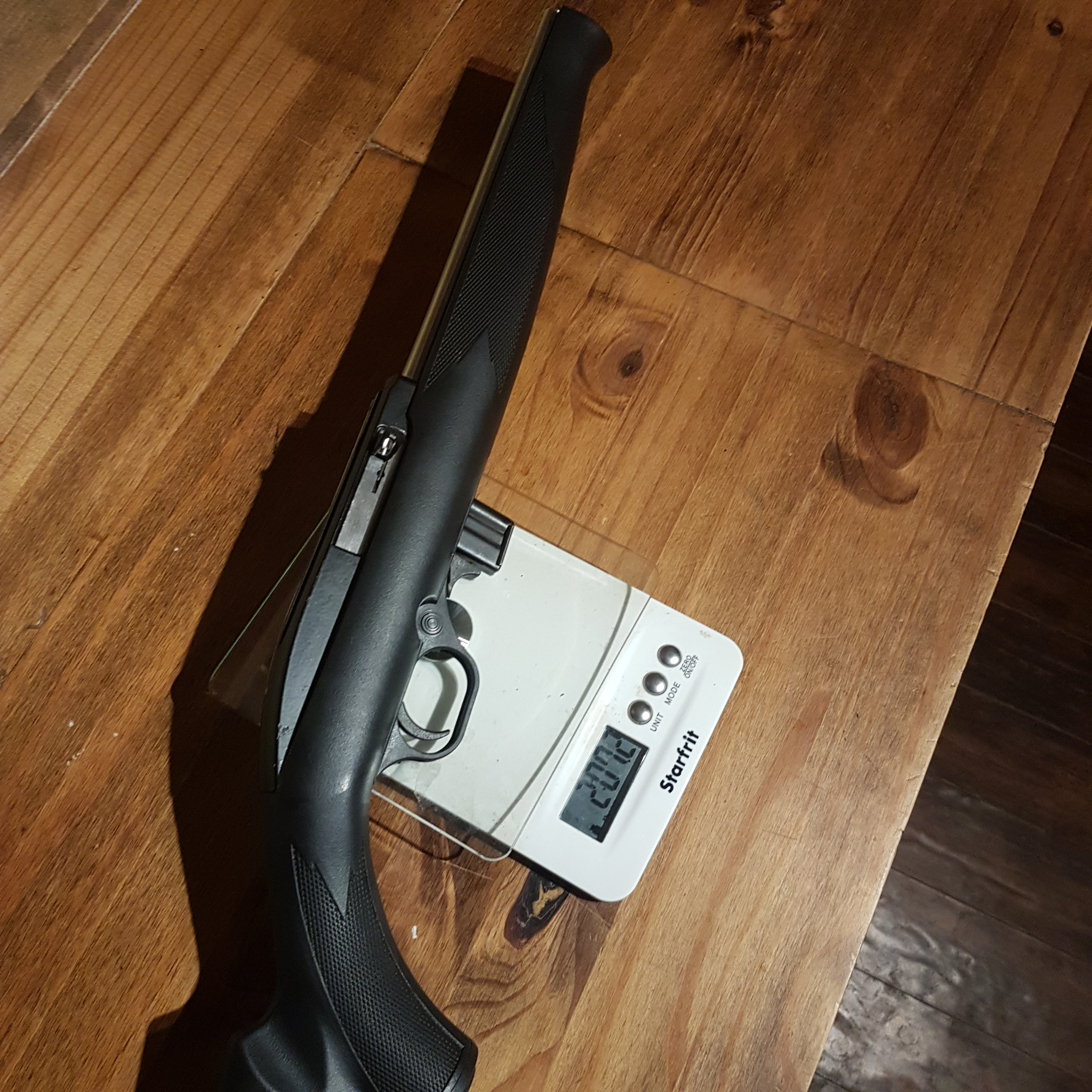

the stock weights 1 pound 1oz, so i still plan to remove what i can from the stock and then find out where else to remove weight to make the rifle weigh 1pound 15oz
so im shooting for under 2 pounds all said and done, i also need iron sights on it, ill make something for a rear slight that sits in the slot in the top of the receiver so gain some sight radius
the main plan is to be able to strap this to a backpack and not even know its there
