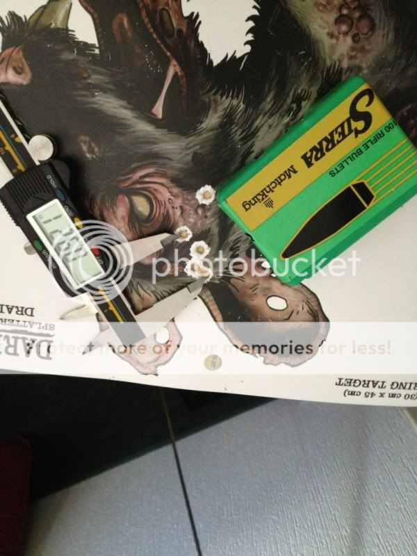

I know what your saying here, Currently i'm looking for a decent factory load that's cheap and will group a bit better then an inch just because... Well... "just because" and for no other reason... I have some 55gr SP and FMJ bullets as well as H4895 and CCI BR primers I will try tommorow in my ever growing collection of fire formed brass... I'm really looking forward to seeing the results.

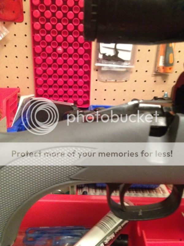

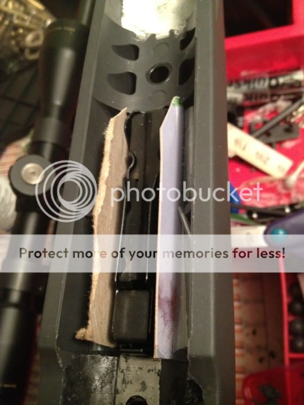

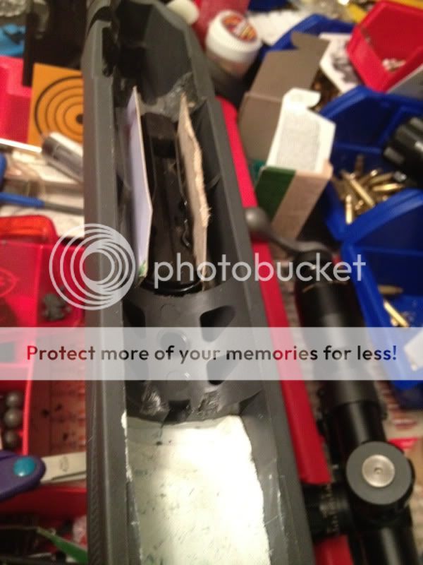

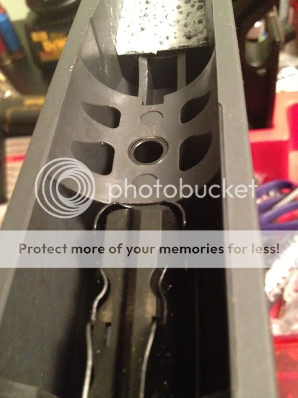

I can see why the Bedding is such a big deal with these rifles... When I get started tonite on the bedding work I will highlight some of the gaps the factory left in various spots... The action is only contacting the stock on 2 points about 1/8" wide by maybe 1.250" long in the front and 1/2" at the back... The recoil lug is not even in contact with the front stock pillar...
