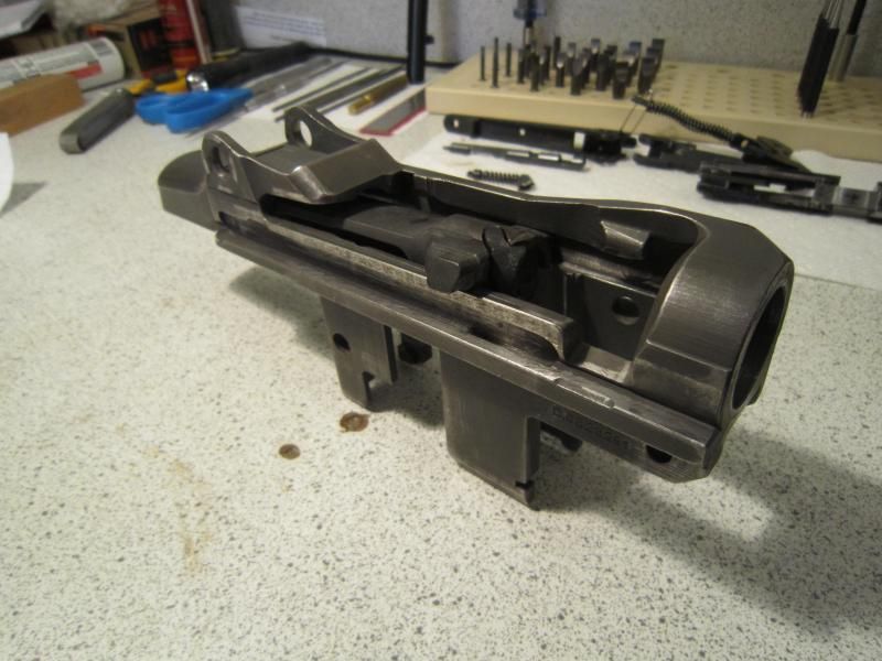

Parts came in today. They're in great shape, physically. No pitting or overwhelming wear, taking in mind they are something like 50-60 years old. There's a small, insignificant dent to a corner of the bayonet lug, but the threading, and barrel lugs are all in great shape. Can't find any problems other than the need for a reblueing, or park-job.
My Numrich Op Rod came in. It's a post-WW2 (Korean War era) manufactured SA rod that measures a .5265". Some light surface rust that will disappear when it gets bead blasted prior to a repark. Tab is a nice tight fit to my receiver with only minimal peening at the corners. I'm well pleased by it.
I just got my SA bolt from Constantine; from Greece it was 11 days in shipping, pretty darn good. The bolt is new with nice Parkerizing. $82 all in, a good deal I think. Guys are paying $200-250 for U.S. M14 bolts.
Here's a photo of my bits so far; a Beretta receiver and my SA bolt. Op rod next I think, while there are still some to be had.
