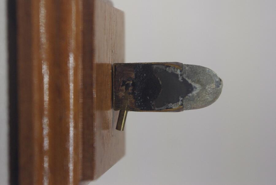

Whenever I am at a show displaying some of my pinfire pistols and revolvers I get a lot of puzzled looks and ample questions about what a “pinfire” is. In fact, one year I even made a cut-away model of a pinfire cartridge to illustrate how it works, after having difficulty explaining the process to a curious customer.
The short history of the pinfire cartridge goes back to 1812 when the Swiss born gunsmith and inventor Samuel Pauli came up with the idea of using a priming device housed inside the base of a brass or copper cartridge to ignite the powder charge. This priming device – a primer as we know it today – was connected to the outside by a brass pin, which protruded from the side of the cartridge and was struck by the hammer. The blow was transferred from the hammer via the pin onto the primer, which set off the charge. The idea of having a self-contained cartridge, primer, powder and bullet all in one was revolutionary at the time. This, of course, was only possible after the Englishman Alexander Forsyth had invented the mercury fulminate primer. Samuel Pauli patented his invention in France on 29 September, 1812, almost sixty years before the American patent for the rim fire cartridge was granted…

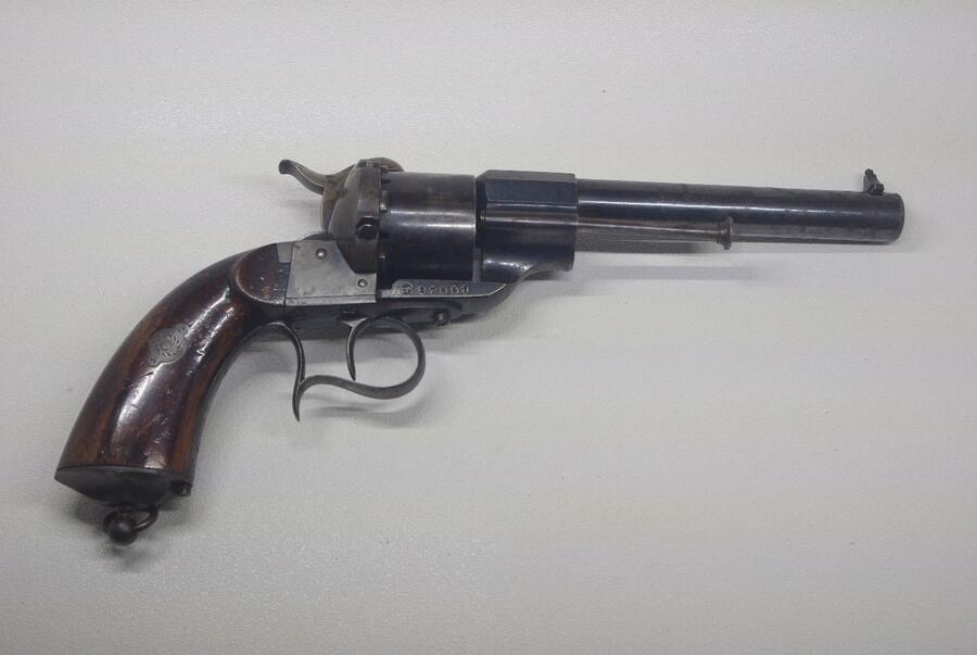

A Lefaucheux Model of 1854 “Army” revolver as used in the American civil war. The serial number range of guns purchased by the Union is still recorded at the US National Archives, and this is one of them. It is a single-action revolver chambered for a 12mm pinfire cartridge.

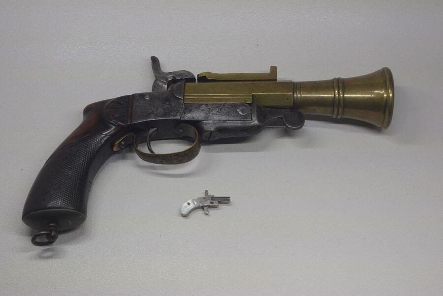

From the smallest 2mm “berlioque” pistol (which is fully functional and shoots a tiny, 2mm bullet) to a 16-gauge Blunderbuss pistol, pinfire guns were made in a huge variety of styles and calibers, and in many countries around the world.

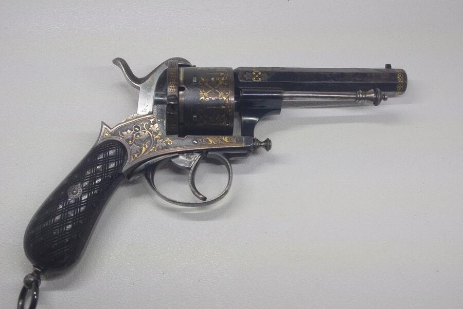

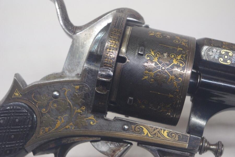

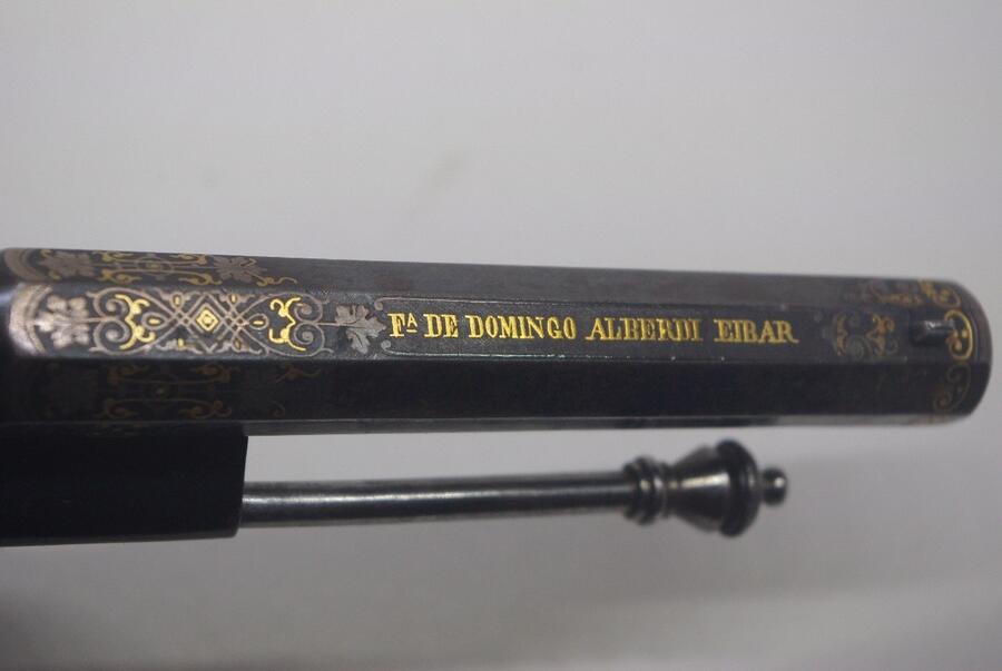

This exquisite gold and silver inlaid, 12mm pinfire revolver by Spanish master Domingo Alberdi would be worth three times as much if it was a Colt or Smith & Wesson…
Domingo Alberdi of Eibar, Spain was active from 1870 to 1888. His high-quality firearms were famous and much sought after.
Cut-away of a 12mm pinfire cartridge. You can see the primer embedded at the base of the pin.
