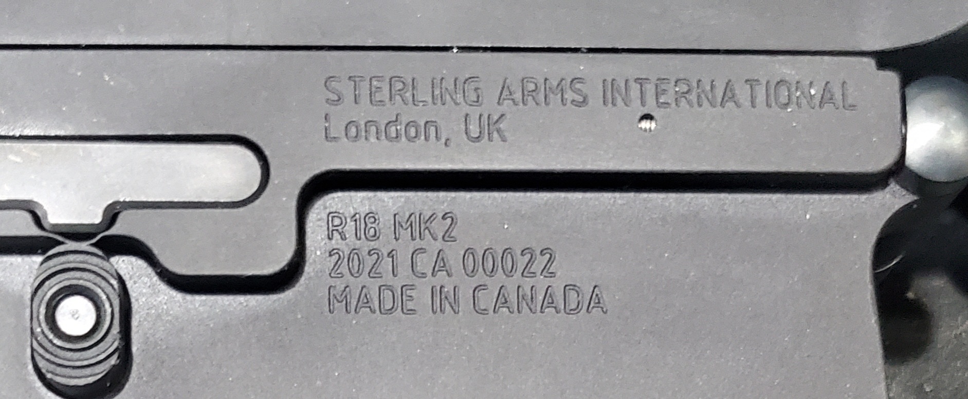

The introduction of the R18 Mk2 is by no means JR Cox nor Sterling Arms International’s first foray into the risky Canadian firearms manufacturing business. As mentioned, they introduced new Canadian/UK manufactured AR-10 and AR-15 style firearms to the Canadian market immediately prior to the infamous 1 May 2020 mass prohibition. As a result of that OIC, JR was left a considerable investment in stock of over 500 unsalable .308 and .223 Receiver sets manufactured by Sterling, UK, which are still collecting dust on a TSE shelf. Never one to rest nor cry over spilt milk, JR (like others) recognized a further opportunity in the non-restricted AR-180B semi-automatic platform. However, instead of bringing another low-budget iteration of the AR-180B to market, JR’s vision was more upscale. He envisioned SAI providing to his organization a blending of familiar AR-style ergonomics with the AR-180B’s operating system, while ensuring no receiver compatibility with existing AR 10 or 15 firearms. The new firearm would be nicely contoured and surface-finished as compared to the lower-budget competition. It would command a somewhat higher price, commensurate with the increased machine time and surface preparation required to produce a smooth, rounded and properly Hard-Coat Anodized external finish. SAI believed they were up to this challenge.
Manufacturer Information - 100% Made in Canada:

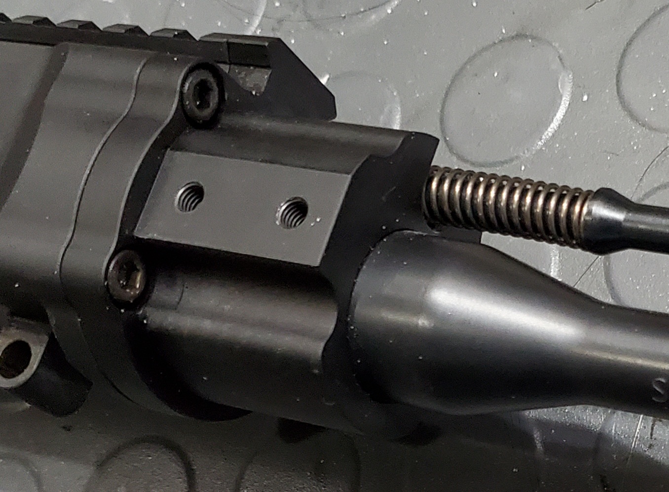

The Rifle-length Gas System consists of a short-stroke piston based directly upon the AR-180B design, with a .750 Gas Journal. The non-adjustable Gas Block is secured to the Barrel by 2 Allen (Hex) Screws on the underside. The Gas Block and Piston System are hidden from view and touch by an aluminum handguard with an interrupted 1913 Picatinny Top Rail and MLOC slots at the 3, 6 and 9 o’clock positions. The lightweight aluminum Handguard is currently affixed to the proprietary Barrel Nut by a series of four screws which must be removed in order to slide-off the Handguard and access the Gas System for maintenance. This shortcoming has already been identified by SAI and a QD Handguard design is already in development for the Mk3 version of the rifle, which I am told is on the drawing board. Removal of the Handguard is a simple matter and Alignment Tabs make re-installing the tube a simple matter. Just be careful not to cross-thread the screws in the Aluminum threads when replacing them.
Barrel and Gas System:

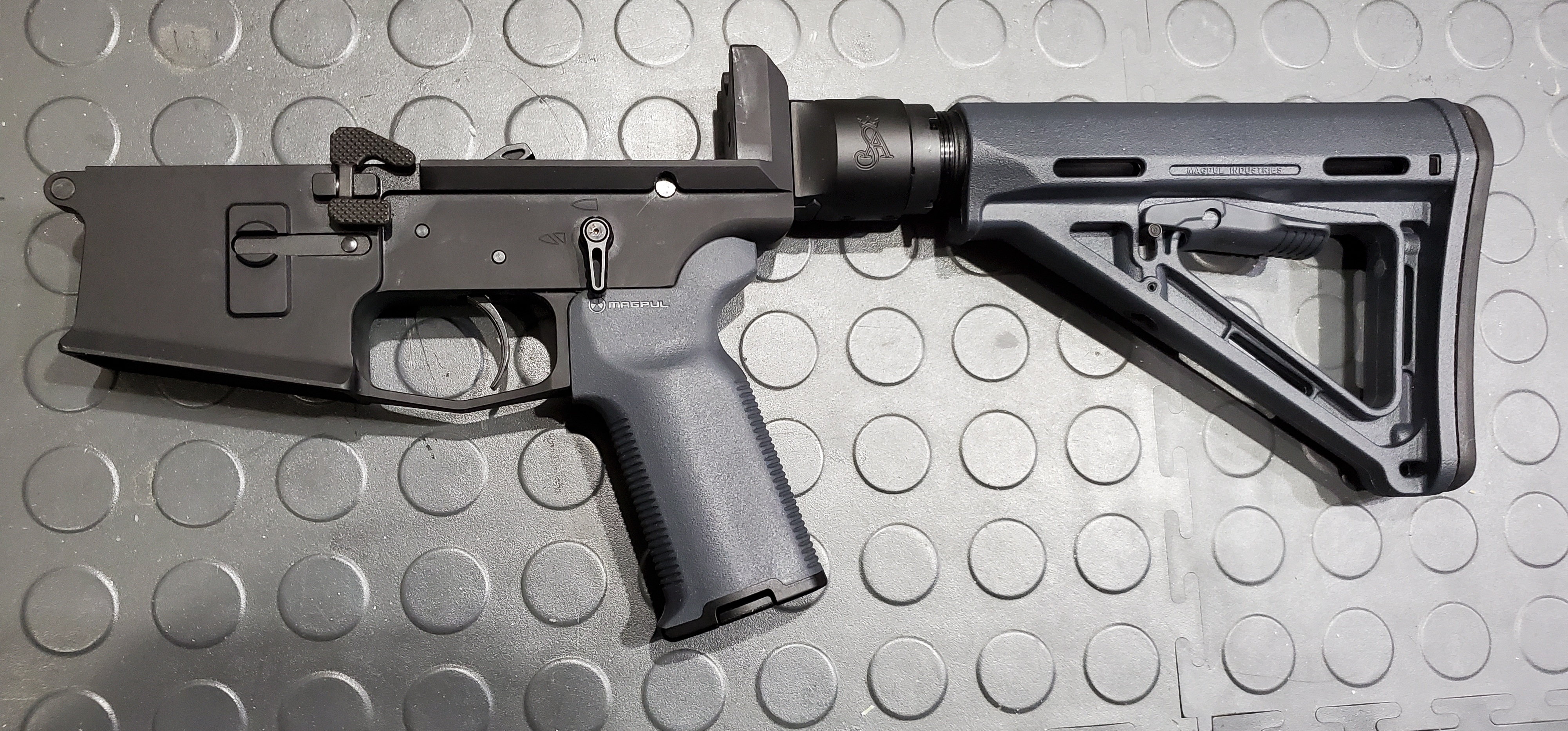

The Lower Receiver features a nicely flared Magazine Well and an integrated Trigger Guard. It accepts generic AR Pistol Grips with a Beavertail and features a 1913 Picatinny Rail on the rear end for attaching a compatible Buttstock or an Accessory Plate. The Pistol Grip provided with the R18 is the Grey, rubber-coated Magpul MOE-K2+ with its comfortable, reduced grip-angle. The ambidextrous Selector Lever is the standard Sterling fare and those who own one of the earlier Sterling “safe queens” will immediately recognize it. The Selector activation is not overly stiff but has positive detents in the "Safe" and "Fire" positions. Although the Selector and Bolt-Release are ambidextrous, the Magazine Release is not. A Norgon-style Magazine Release would easily address that minor shortcoming for those who prefer a Magazine Catch on the Left Side of their rifle. The Magazine Release is adequately protected from accidental activation by the contours of the Lower Receiver. The rear-most pocket in the Lower Receiver is fitted with a Tensioning Screw which places pressure on the bottom of the Upper Receiver to effectivey remove slop between the two Receiver halves. This system is identical to that employed by Aero Precision for those familiar with those Receivers.
Lower Receiver - Left Side:
The stock trigger is 100% “Mil-Spec” AR15. It is single-stage, fairly smooth with a crisp, clean break at an average of 6.5 lbs pull. Reset is not too bad. You be the judge, but I exchanged the stock Trigger in my sample rifle for an adjustable Trigger Tech aftermarket unit. Night and day! The R18 Lower Receiver is specifically engineered to accept the Canadian Trigger Tech after-market, custom Trigger pack with user-adjustable Trigger pull-weight. Geissele Triggers ought to also work, along with most brands of after-market Trigger be they the cassette-type or the separate Hammer and Trigger set-up. With the R18 the maker and type of after-market Trigger is your call….
Lower Receiver - Right Side:

Purchasers of the R18 Mk2 will receive a rifle with a Fixed tubular Receiver Extension and a Gray Magpul CTR Buttstock. The Mk3 version expected will feature the Magpul Zhukov Folding Buttstock, which will also be backwards-compatible with the earlier Mk2 rifle. Both Buttstock options accept Cheek-Risers and come with QD Sling cup options. The Zhukov stock will allow the R18 to be fired with the stock folded a-la the 1980s, or with the Buttstock extended for maximum stability and accuracy. As far as the Mk2 is concerned, the non-folding Tubular Buttstock is extremely comfortable with a solid cheek-weld – just as you would expect from Magpul. Of course, with the Rear Picatinny Buttstock attachment system any Buttstock that is so equipped can be mounted. I have a “Safe Queen” SIG MCX which temporarily donated its Folding/Retractable Buttstock to the R18 Mk 2 just to see if it could be done and it was no problem.
Buttstock Interface:
The Picatinny attachment for the Buttstock means that in theory, the Stock height can be adjusted to suit the firer’s individual preferences. However, as currently manufactured the rear Picatinny Rail is quite short and adjustment from the center position will leave a portion of the Buttstock clamping system hanging over empty space. It is my belief that the Picatinny Rail should be extended one more increment upwards on the rear of the rifle so that additional adjustment can be made to put the Buttstock slightly over the line of the Barrel. This would serve to reduce any muzzle-flip as well as bringing the cheek-weld a bit higher and possibly more comfortable for certain optics users.
Buttstock Interface 2:
Users will want to note that the Buttstock’s Picatinny clamping system adds approximately 3.5 cm of non-collapsible length to the Receiver Extension. It is also worth noting that with the Picatinny system it is currently not possible to attach an unmodified A2-style solid stock. I have been told that SAI will have an adapter shortly for this. That also said, Midwest Industries in the States produce a variety of different stock styles with the same Picatinny interface, which is definitely the way of the future for attaching different Buttstock options.
SIG MCX Buttstock Fitted to R18 Mk2 Picatinny Interface:

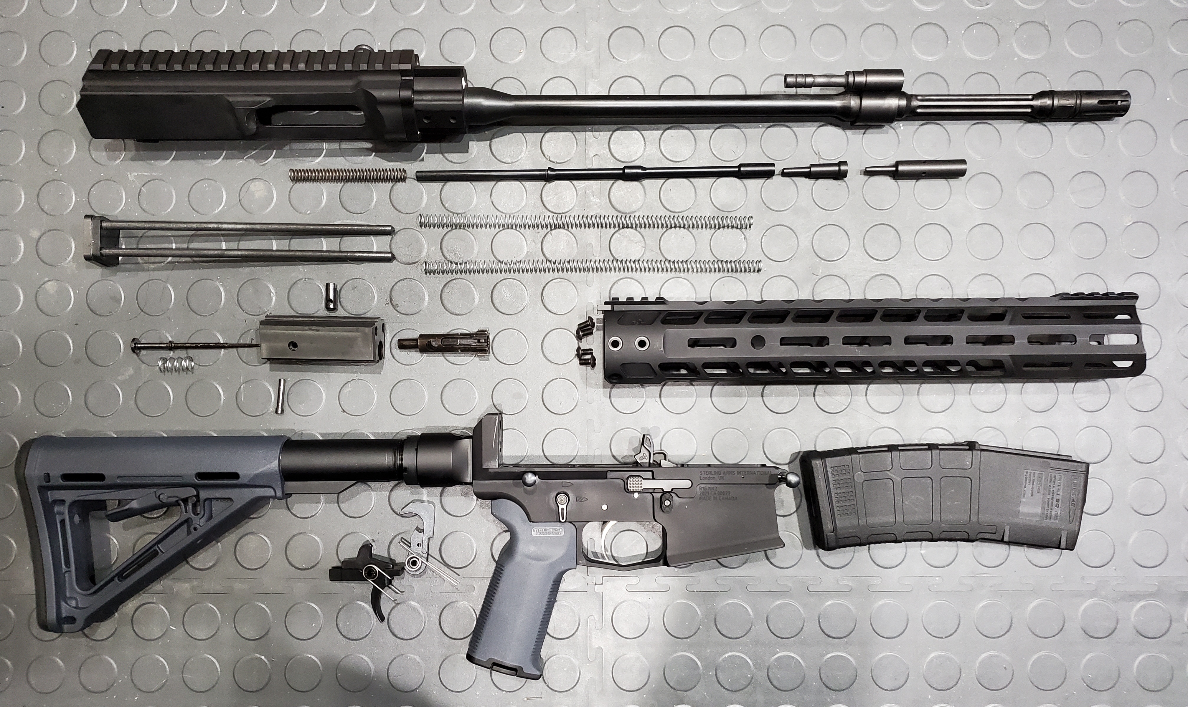

Stripping and reassembly of the R18 Mk2 are both simple and intuitive for anyone familiar with either the AR15 or one of the AR-180B designs currently on the market (The rifle does come with a downloadable manual). Simply push out the Rear Take-Down Pin and slightly depress the Rear Plate of the Recoil Assembly which will allow the Upper and Lower Receivers to pivot open and away from each other. If you wish to fully separate the Receivers simply push out the Front Take-Down Pin and the Upper and Lower will come apart. From there the Upper Receiver can be further stripped by racking the Cocking Handle and withdrawing the Bolt Carrier/Bolt/Guide Rod/Operating Spring Assembly from the Upper Receiver. From there, the Bolt Carrier and Bolt can be easily separated from the Guide Rods and Operating Springs by simply pulling. Removing the Bolt from the Carrier is a matter of pushing out the Firing Pin Retaining Pin from Right to Left on the Carrier, removing the spring-loaded Firing Pin from the rear of the Carrier, Removing the Cam from the Left side of the Carrier, and finally pulling the Bolt out of the front of the Carrier. Detailed stripping of the Bolt itself (eg. Extractor and Pin) is the same as any AR-pattern rifle.
Field-Stripped R18 Mk2 (Note that the Factory Trigger has been replaced by my TriggerTech for Accuracy testing):
Reassembly is simply done in the reverse order. Ensure 2 things as you proceed with reassembly:
1. Depress the rear of the Firing Pin when re-inserting the Firing Pin Retaining Pin, and
2. Make certain that the Operating Springs are fully seated within the Bolt Carrier by pushing the Carrier down along the Guide Rods (simulating the ejection cycle) until the Springs become visible in their holes at the front end of the Carrier.
The Gas System need not be serviced every time the R18 Mk2 is Field-Stripped for maintenance, however it is also rather easily accomplished. Once you expose the Gas System by removing the previously mentioned four Handguard Screws and the Handguard itself, stripping the actual parts is a relatively simple matter. Pull downwards on the long Push Rod, compressing the Spring. This will create sufficient space near the front of the system to withdraw the central Spacer. Once the Spacer is removed, simply pull the Piston Cup down off of the Piston/Gas Block. Reassemble in the reverse order.
Gas System Field-Stripped:

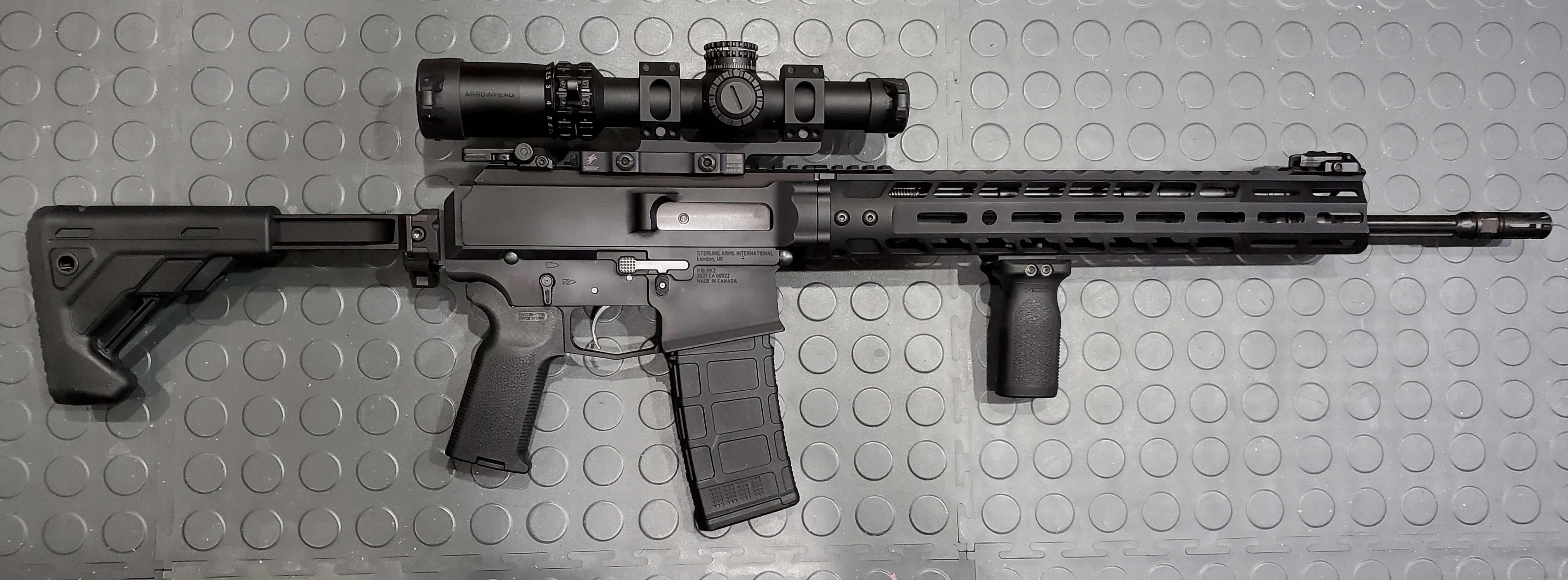

A potential show-stopper for some will be the fact that the R18 Mk2’s Upper and Lower Receivers are fabricated from T6061 aluminum alloy, and not the harder T7075. I don’t have a dog in this fight and understand that there are pros and cons associated with the use of each material. At the end of the day, JR noted that T6061 is easier to cut and therefore requires less expensive machine time to fabricate each component. Added to that is his belief that the more ductile T6061 will withstand the explosive forces of a detonation out-of-battery better than the more brittle 7075-series counterpart. He may have a point there, not that anyone is anticipating breech explosions in the R18! In any case, the Sterling Arms International AR10 that I owned for a brief time was fabricated from T6061 as well, and there were no issues arising from use of the slightly softer alloy.
Upper Receiver - Top View w/ 14" Handguard:
The Finish on the R18 Mk2 is a combination of matte black Type III anodizing on the 6061 Aluminum and QPQ Nitride on the steel components with what appears to be Parkerizing on some small steel parts. I note that the anodizing does not appear
to be all that thick/durable as both rifles received for testing had exposed aluminum on the sharp edges of the Brass Deflector after firing approximately 300 factory test rounds following assembly. Sterling’s Canadian Operations Manager related to me that there had been some difficulty in obtaining consistent anodizing colour from sub-contractors early in the production process, so it stands to reason that the anodizing system may still be tweaked as the R18 Mk2 enters full production.
Lower Receiver - Top View (Note that my TriggerTech Trigger is installed for Accuracy Testing):
