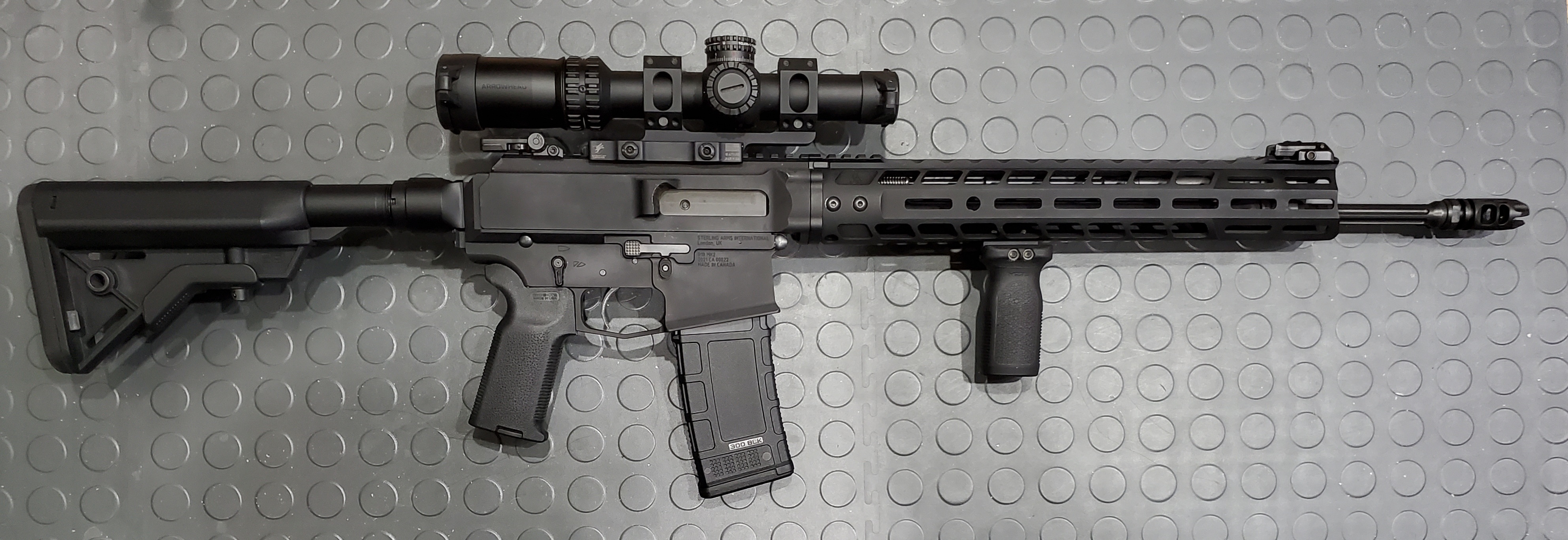

Due to a late start following my family’s annual Remembrance Day observances, I only managed to fire an approximate total of 160 rounds through my two assigned test rifles during my first live-fire outing with the R18 Mk2. The ammunition consisted of a mix of 55, 62 and 77-grain bullet weights, and included both bulk and factory-boxed rounds. All firing was done at the Canadian Historical Arms Society (CHAS) Outdoor Range at Genesse, AB. The ambient temperature reached a daytime high of 3C during Accuracy and Reliability testing. Winds were calm and did not adversely impact accuracy testing.
CHAS Genessee Range, 100-800m Firing Point:
For accuracy testing the rifle was fitted with a TriggerTech AR-15 Adjustable 3.5 lb - 5 lb Trigger, a Magpul MLOC Bipod, and a Leupold Mk 5 HD 5-25x 56mm optic with Tremor 3 Reticle. For casual “plinking” out to 400m following 100m accuracy testing, I traded the Leupold for a more compact and low-key Swampfox 1-10x 24mm Low-Power Variable Optic (LPVO) in an American Defense QD Cantilever mount and ditched the Bipod.

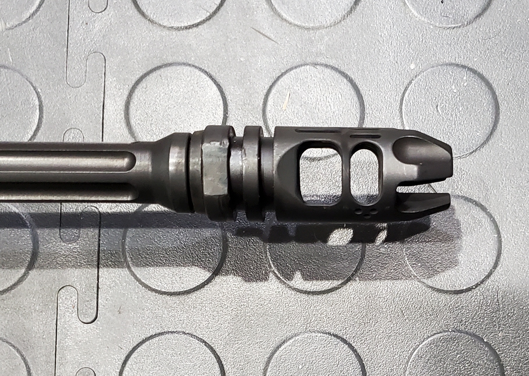

As far as the shooting experience is concerned, the long, rifle-length Piston operation results in an extremely mild perceived recoil impulse. Recoil reduction is further enhanced by the SAI combination Flash-Hider/Muzzle Brake, which seems to be effective in both roles. The exception to the rule was the Russian Barnaul ammunition, which produced Basketball-sized fireballs with each press of the trigger. I also trialled a knock-off Epsilon VG-6 Flash-Comp for the sake of direct comparison, which provided even greater recoil mitigation, but at the cost of a larger physical profile and a much more violent side-braking effect.
Knock-Off VG-6 Flash-Comp:

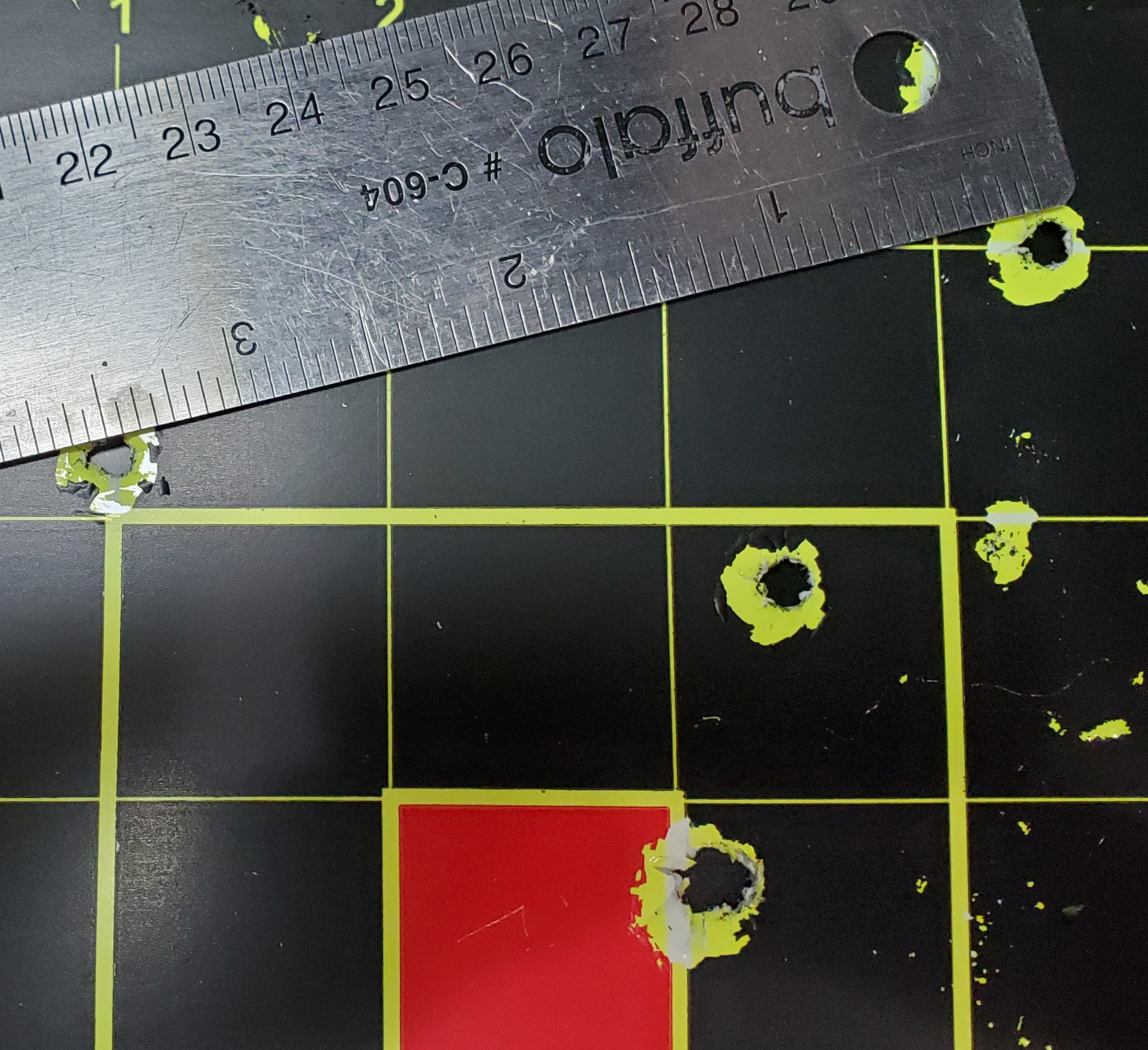

Accuracy varied considerably with the type of ammo being fired, as it always does. The best results hovered just under 2” (2 MOA), 5-round groups at 100 metres using PMC X-Tac 62 grain ammunition. The worst results were approximately 3” (3 MOA), 5-round groups at 100 metres using Russian Barnaul brand, 55 grain ammunition. It is worth noting that even the worst accuracy results were still acceptable at 3 MOA. See sample grouping targets below:

That being said, I don't think the ticket correlates with the accuracy. It may be ugly, but 2 different MCR's I've tested are consistently sub-MOA with 62gr X-TAC and even better with 77gr GMM. With FINELY tuned handloads I was seeing 0.5 at the bench. I'm really hoping you just had an off day or a subpar unit because at the very least i was hoping for a minute from the X-TAC. I'll be looking forward to seeing other range reviews. Thanks for your time and effort Mark.
I think that you should prepare yourself to be consistently disappointed if you're expecting consistent sub-MOA performance out of ball ammo...
Where did I say that? I stated that I was HOPING to see 1 MOA out of the 62gr X-TAC, which is a very reasonable expectation for a semi costing upwards of 2.6k. I don't think this is a reasonable expectation for the steel case, or even lake city or federal ball varieties.
My modern sporter with a bsf CF barrel shot sub moa with AE bulk all day every day. In a 5 round group 3-4 rounds would be dam near all touching with a flyer opening the group up to just under an inch.
I think with the pencil barrel on the SAI R18 MK2, the accuracy will suffer. There is a reason H&K has gone mostly DI on their DMR rifles; all of that extra mass and movement with a piston.
We may have to ask SAI to add a bit more stiffness to the barrel. But 1.5 MOA with PMC Tac is not horrible by any means.
