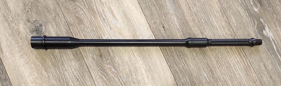

Is it possible to see the barrel and barrel nut interface with the upper receiver pulled apart with an exploded view?
In Bartok5's part 1, he did some pretty decent photos with the rifle disassembled.
Beltfed.... here you go.
JR
