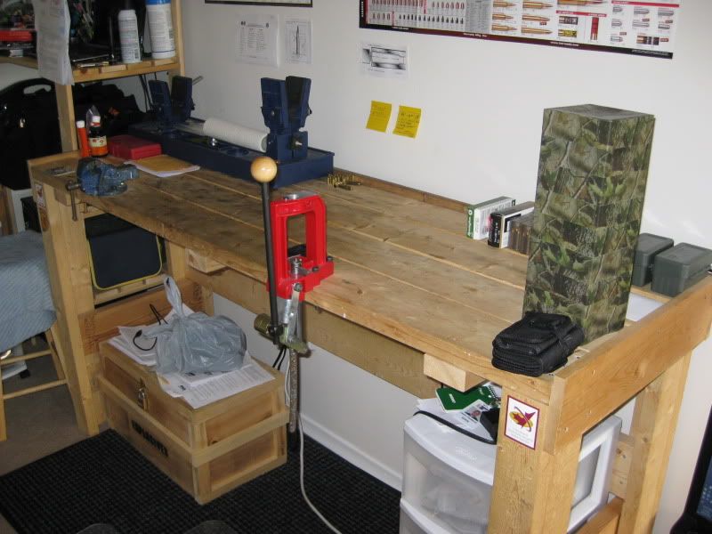

I know this is overkill, but I just wanted to show you my bench in case it gives you any ideas. Everything is made from 2x6's except the 3/4" sheet of maple plywood on top.

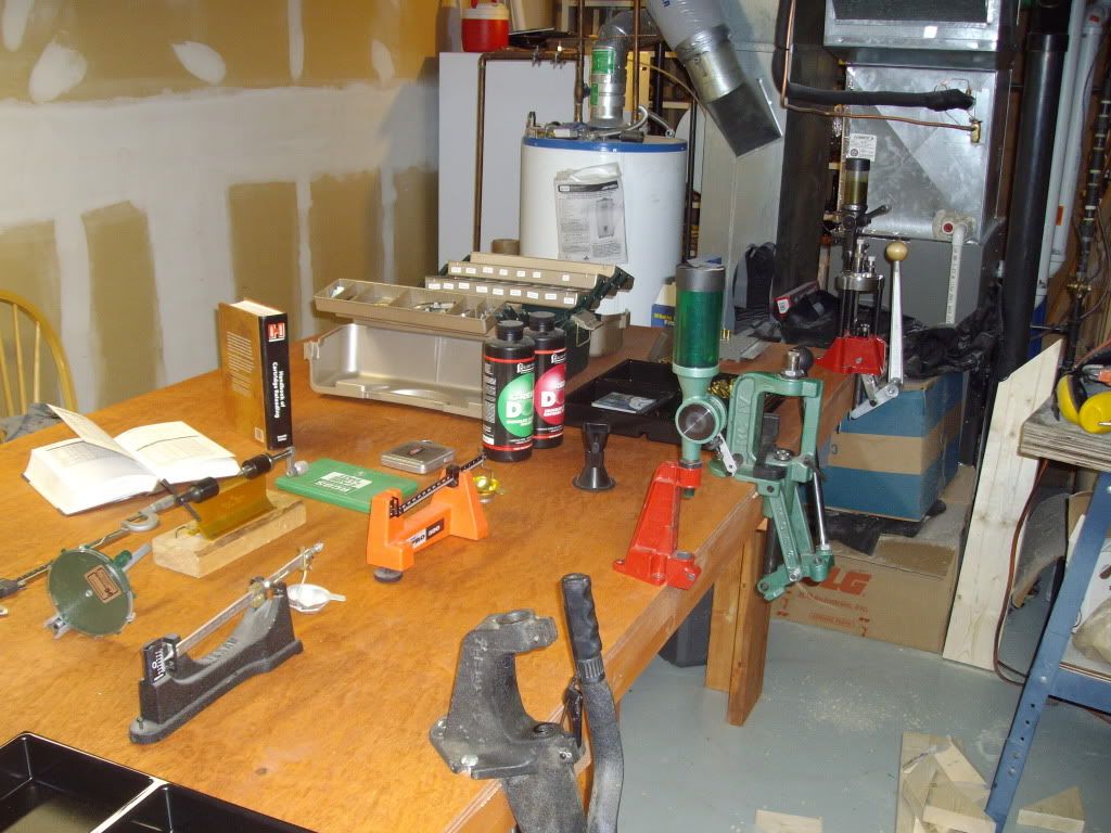

30 year old craftsman work bench, warped wood top, RCBS Press lag mounted to 3 pieces of nailed together 18 inch long 2"x12" I found in the garage, and C-clamped to the workbench. I'm thinking of putting out a commercial version of my set-up, look for it all the finest garage sales. The press portion weighs about 20 lbs, and I'll be surprised if running the biggest dryest cases possible would make it flex in the slightest.
ETA it's a definite upgrade from my previous press board top desk, which despite all the warnings, sized and loaded at least 2-300 .300 Winchester magnum rounds, over 500 each of 22-250 and 44 magnum, and about 3000 rounds of 45 acp, without ever falling apart or even cracking. I even used it as my main work bench during home renos, and the only time it took any damage was when I hurt my hand, and smashed a couple holes in it with a hammer.

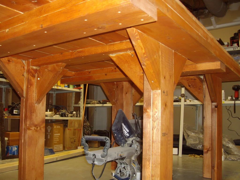

I used a doubled layer of 3/4 inch plywood, glued and screwed, with the rear of the bench screwed into a 2x6x8foot board tapcon'd to the concrete wall. The front of the bench sits on an arch made from 2x6 with a 4x4 post at the ends.
