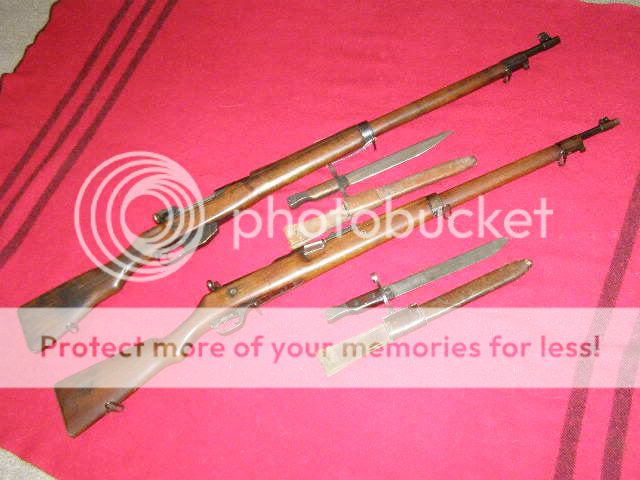

The Ross full wood rifles are extremely hard to find. I have had the MkIII for years, but it took me seven or eight years to find my MkII*****. Not exactly museum quality but they are good examples.
