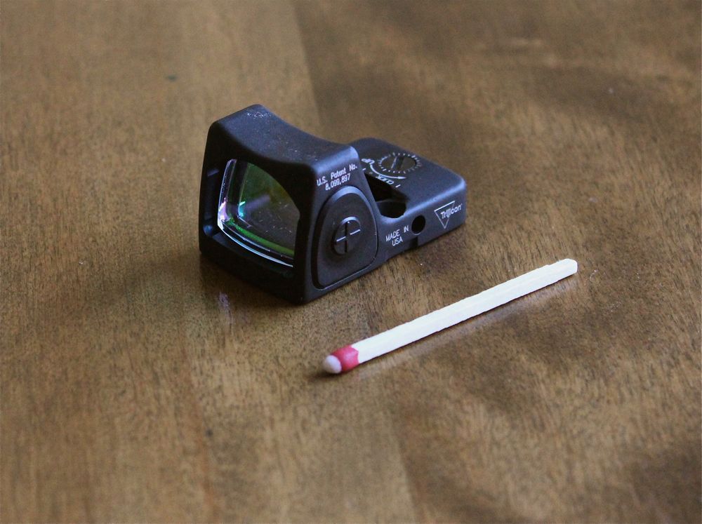

I ordered one from P&D Enterprises—you can order the sights with a variety of mounts or without a mount at all, which is what I ordered. When the sight arrived I was really surprised at how small it really was!
It’s also heavier than it looks, due to I think the thick glass and rugged construction. It’s still only 33 g (or 1.17 oz) though so it’s very lightweight. It is almost unnoticeable on the rifle

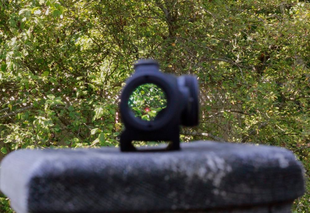

Here’s the field of view through a 4 MOA Aimpoint Micro for comparison.

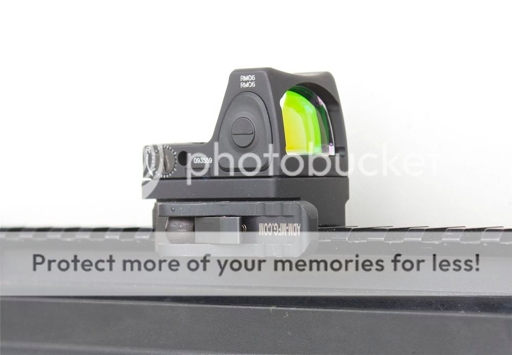

Here’s how it looks on the mount:
You can see the “+” and “-“ brightness adjustment buttons on either side of the window—there are eight levels of brightness (including two night vision modes that unless my life takes an unexpected turn I will not likely not use). I find that for daytime use setting 3 or 4 work fine for me. The windage adjustment is also on the right side—there’s a similar elevation adjustment on the top, both with 1 MOA clicks.

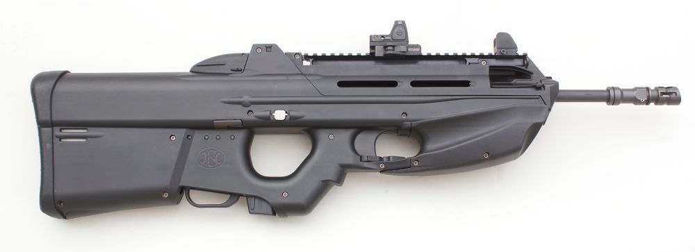

Here’s how it looks on the rifle:
I experimented with various mounting positions along the rail. I found that closer to the front blocked the front sight “wings”. I use the wings in the lower part of my sighting window for a visual reference to ensure I’m not canting the rifle, and closer to the rear the field of view was blocked more than I liked. Having it midway along allows for quick acquisition and easy access to the brightness controls.
